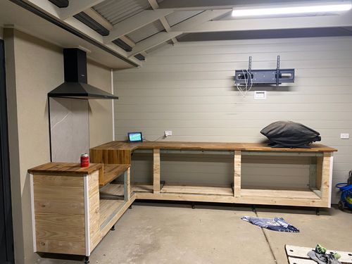

Aaron designed, built and completed this outdoor kitchen/bbq area from scratch, utilising an existing pergola.
This project has given us another valuable entertaining and relaxing area with bonus privacy and shelter from incoming westerly rain/wind.
Electrical outlets by licenced electrician.
Materials
Tools
Stud and noggin framework - 90x45 structural pine (Bunnings)
Colourbond in Ironstone and Classic Cream (to match existing house colours)
Tongue and Groove pine planks (Bunnings)
Cupboard fronts from tongue and groove planks also.
Sarking
Bench top - acacia bench top (https://www.bunnings.com.au/practa-2200-x-600-x-26mm-acacia-timber-benchtop_p0216266)
Paint - Ironstone and classic cream (Bunnings)
Black handles (Bunnings)
Nail gun, hammer, air compressor, mitre saw, fix out gun, straight edge, spirit level, scroll saw, chalk line,angle grinder, tape measure (used a lot!), orbital sander, painting tools, hand tools
Steps
Step 1
1/6

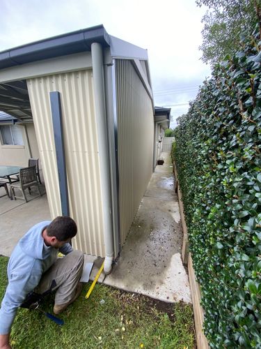

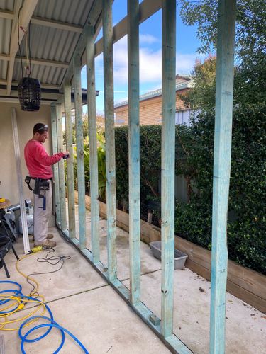

Marked out and framed. Then measured and attached Colorbond to outside.
Step 2
2/6

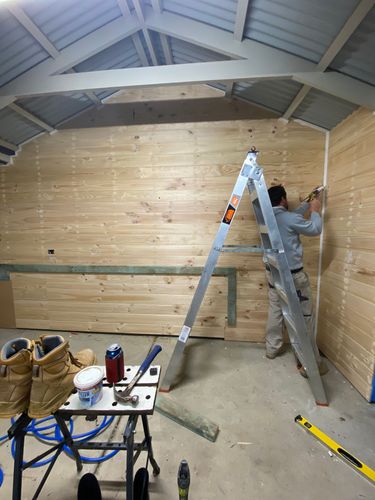

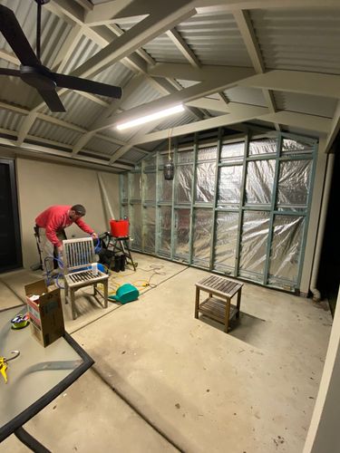

Sheeted the framing and painted the Tongue & Groove
Step 3

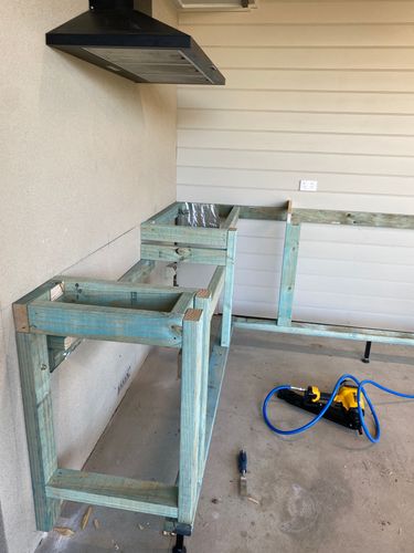

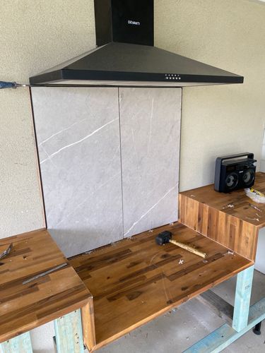

3/6Framed the benches and cupboards. Installed the bench top, rangehood and backsplash tiles.
Step 4

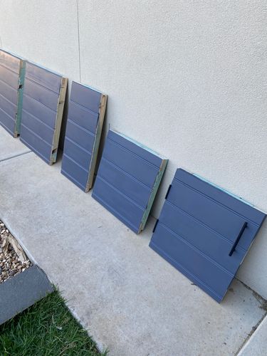

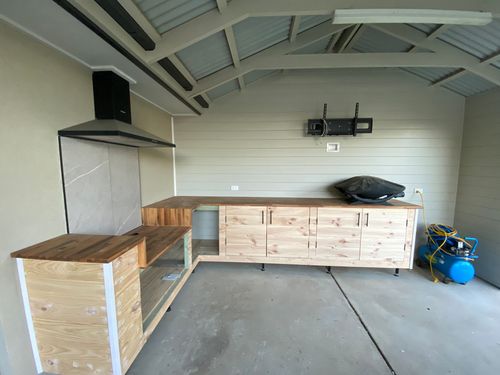

4/6 Painted cupboards (whole family affair)
Step 5

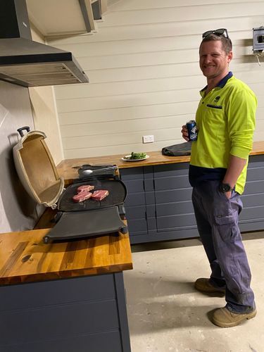

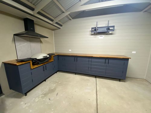

5/6Install cupboard doors. Check out how good the Weber looks!
Step 6
6/6

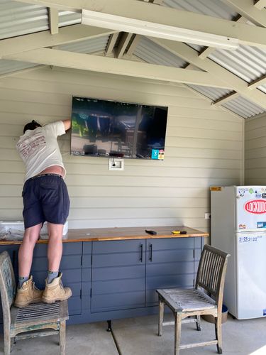

Christen your new outdoor kitchen/BBQ area with a beer and a barbecue.
install TV and beverage fridge 👌🏻
