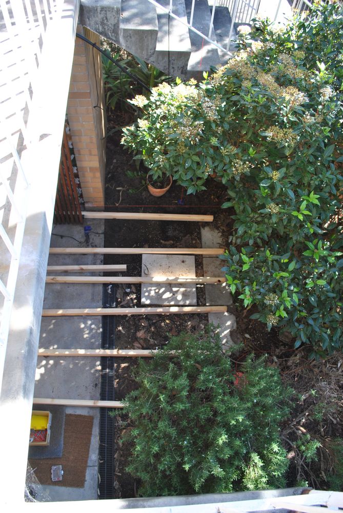

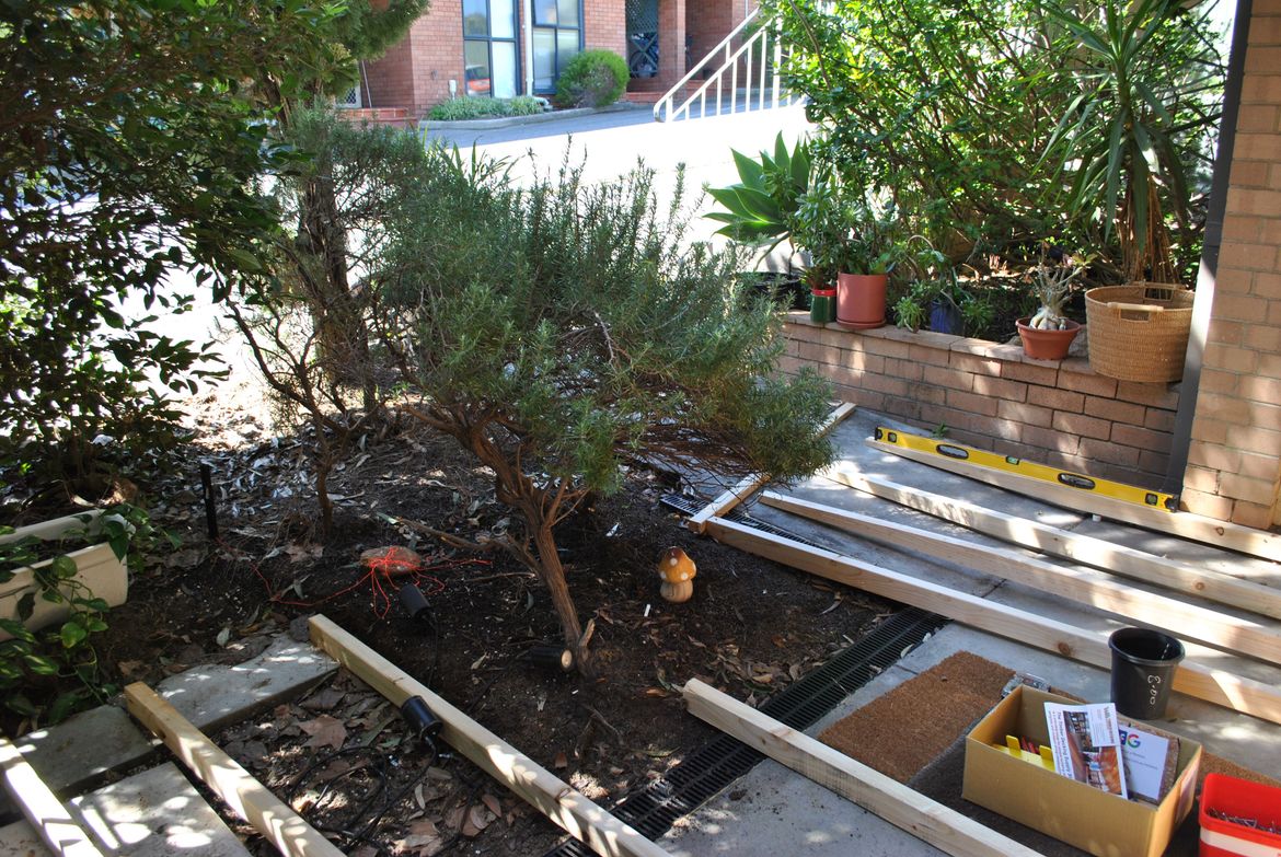

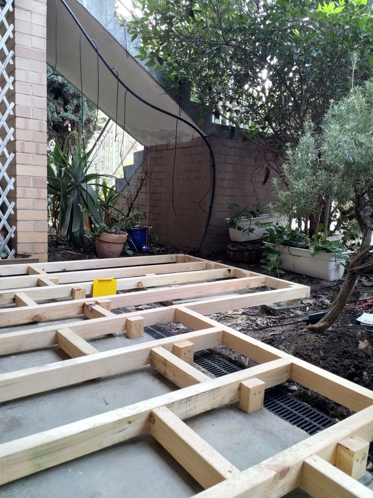

Installing a soak well, building the subframe, and installing a concrete footing for the pergola post.

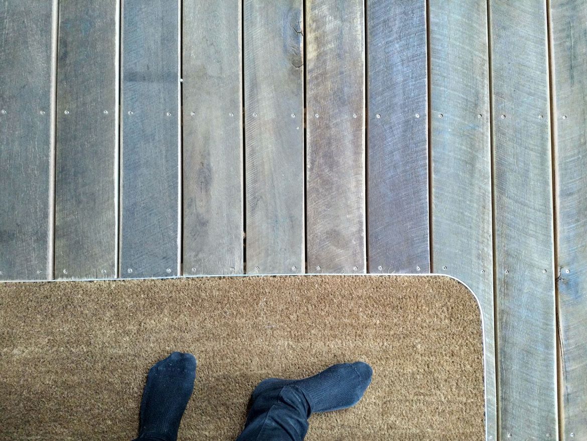

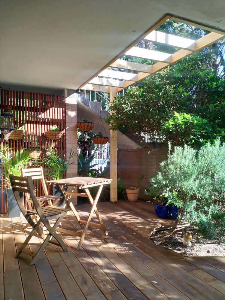

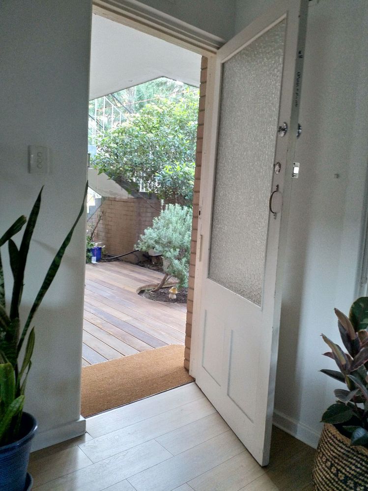

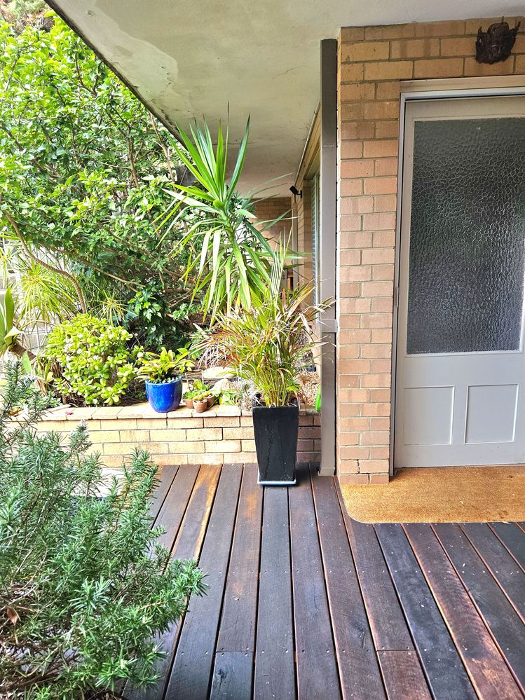

Decking is made from old recycled powerlines poles. We cut the decking in a circle around an existing rosemary bush, and installed a merbau timber screen for privacy and a place to hang plants. Since people have trouble finding our front door, we 3D printed a cover for an outdoor light to aid wayfinding at night. A stainless steel angle was curved and set into the timber decking, so the front door mat is flush with the inside and outside floor level.
The deck has taken a small unusable concrete space and made it a pleasant outdoor area.

What a fabulous transformation, I personally prefer timber decking as it is so much more comfortable on the feet rather than walking on bare concrete. Can you please tell me what timber size you used for your decking frame? They look quite large on the photo, but are they standard 90x45 in size?
Your front porch looks so much more inviting now and your mini pergola adds a nice touch to the overall look of the area. Did you assemble it on the weekends, or did you just do it over several days?

Yes that's right, we used 90 x 45 pine for the subframing. Some peices are cut on an angle to deal with the concrete which slopes down towards the front door. Not so good for drainage but we fixed that by installing the strip drain and soakwell.
With two of us, we completed the project over 2 weekends. Then stained the timber the following week.
