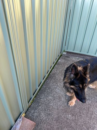

My boundary fence has a gap both next to and below the fence, and unfortunately my dog and my neighbours dog have ‘fence wars’ because of it.

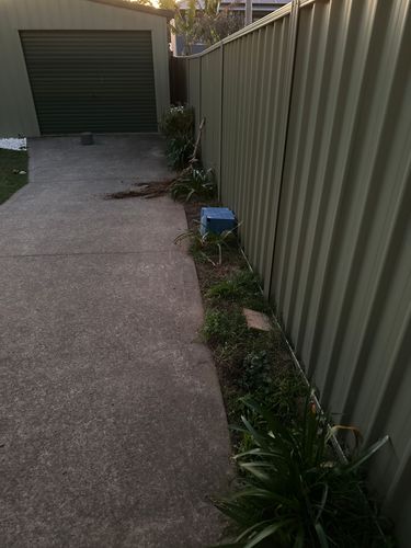

The gap under the fence varies  as the property is slanted and previous owner just used bricks which have started to shift as both dogs try to dig under (there’s a side garden that’s pretty dug up and useless to be honest).

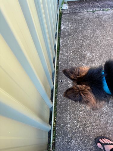

The gap between my driveway and fence and about 4-5cm but changes as the driveway thins.

(Between driveway and fence gap)
(Garden bed next to fence, dogs digging up)

You could attach sleepers to the bottom of the fence the entire way along. These can be secured and screwed into the fence's upright posts. Perhaps blocking the view will be enough to stop your pup from digging in the garden bed. However, I suspect they might also be doing that for fun and not just to try and get next door. Perhaps you could lay pavers in front of the sleepers, so at least 30cm from the fenceline cannot be dug. Or, you could lay sleepers on their face in front of the ones you attach to the fence. Adding trench mesh slightly under the soil could also be a solution.

I was thinking of filling in the garden bed with white decorative stone but I’m not sure how that works with drainage? And i’d hate to flood my neighbours yard when it rains haha
Would it be layered like;
- Soil
- Weed mat
- Trench mesh
- White decorative stones
Re: How to fill gap under boundary fence
Adding white decorative stones sounds like a great idea @KimNorman. Your layer order sounds right, and I can't see how the drainage situation would change by adding the pebbles. The rains will seep through the pebbles and weedmat just as it did before with the soil.
