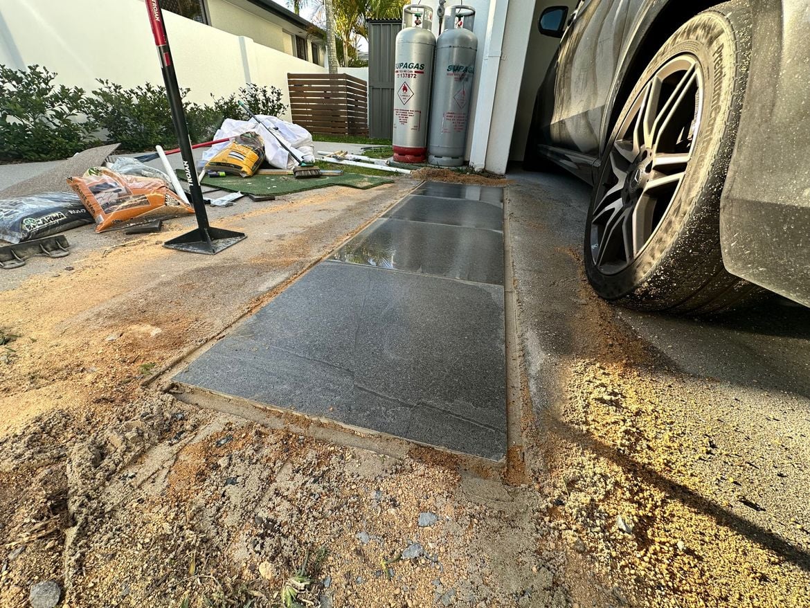

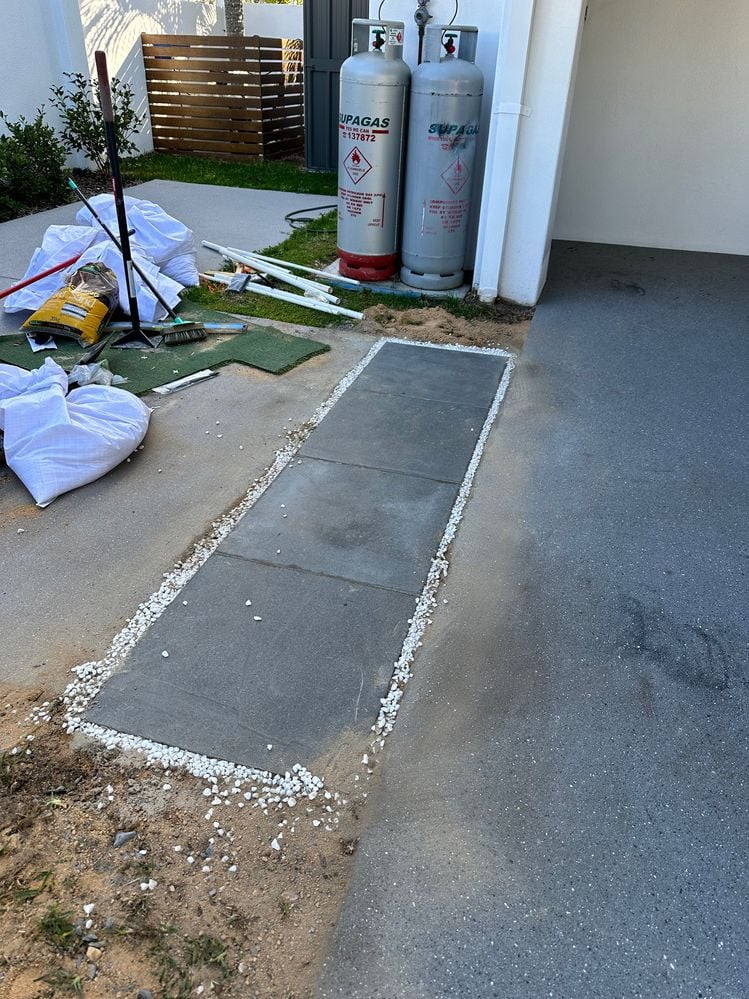

Hi folks, need your advice. Just put in porcelain pavers next to the concrete driveway. I excavated soil, then added roadbase layer followed on top by sand layer. There is a small gap between the pavers and the driveway concrete which I've tried filling with gravel. However, the gravel layer is quite shallow and they are easily dispersed when walking over them.
Is there a better way to fill the gap or stabilise the gravel? I am open to any suggestion.

Instead of stones would you consider using some Merbau decking and either cutting it lengthways half the width (ripping the timber) or leaving it as and putting it in that verticaly between the concrete driveway and tiles? I know its timber in the ground but its hardwood and if you oiled it again before putting it in it might be ok.
If you did a whole large rectangular box deal that would frame the pavers nicely and do away with the need for pebbles?

The concrete driveway the pavers are abutting do not have clean vertical edges, unfortunately. So I cannot use the very nice merbau decking to slot in, unfortunately.
I thought about putting in a strip of artificial turf instead. Not sure.

Rats! mmmm How about pratia pendunculata or zoysia zoysia tenuifolia instead? Just make sure the ground is a little lower in the chanel so foot traffic dosnt hurt the plants so much as the become established?

It's great that you've received excellent advice from @Dave-1. If you do decide to use artificial turf, I suggest using Selleys 350g Heavy Duty Liquid Nails. It is very strong and designed for outdoor use.
My only other suggestion is to explore the possibility of making the channel deeper. If you manage to go just another 30mm deep, it will provide enough space for the pebbles to settle in and not get kicked around.
