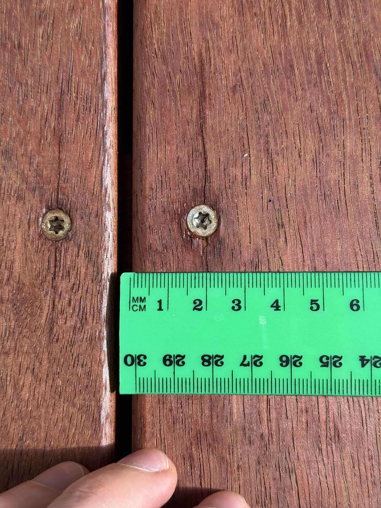

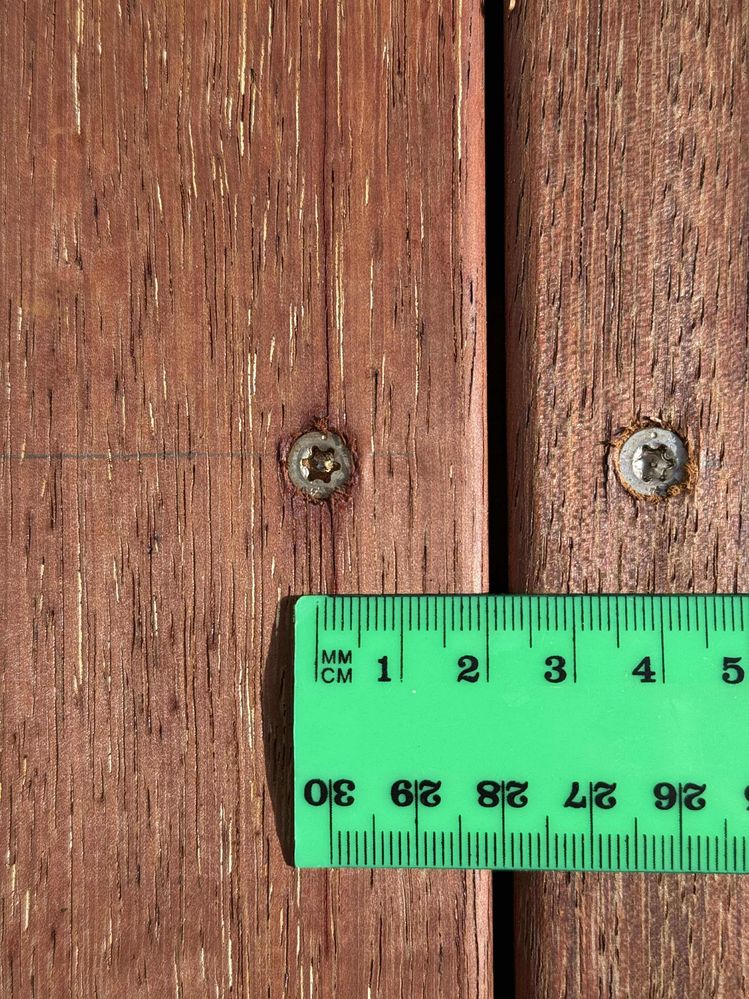

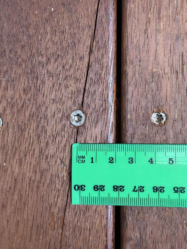

The wedges in the photos are marking some of the cracked areas.

The majority of the cracks are at screws that are closer than 20mm from the edge, however quite a few are at 20mm. I've attached a few more photos.

Yes, dry timber will lose some of its flexibility and is likely a contributing factor to the cracking.
Ultimately, a combination of things will have caused the cracks and if the installer were to do it again, they should predrill all the boards to ensure it doesn't happen again.
