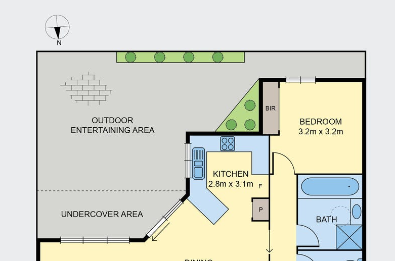

This the layout of the space:

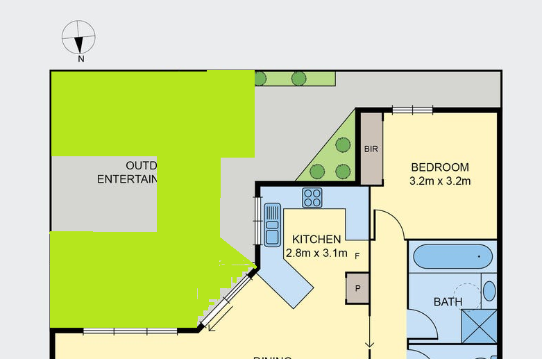

Roughly, the idea is a deck like this marked out in green to maximise the sunny part and avoid existing drains:

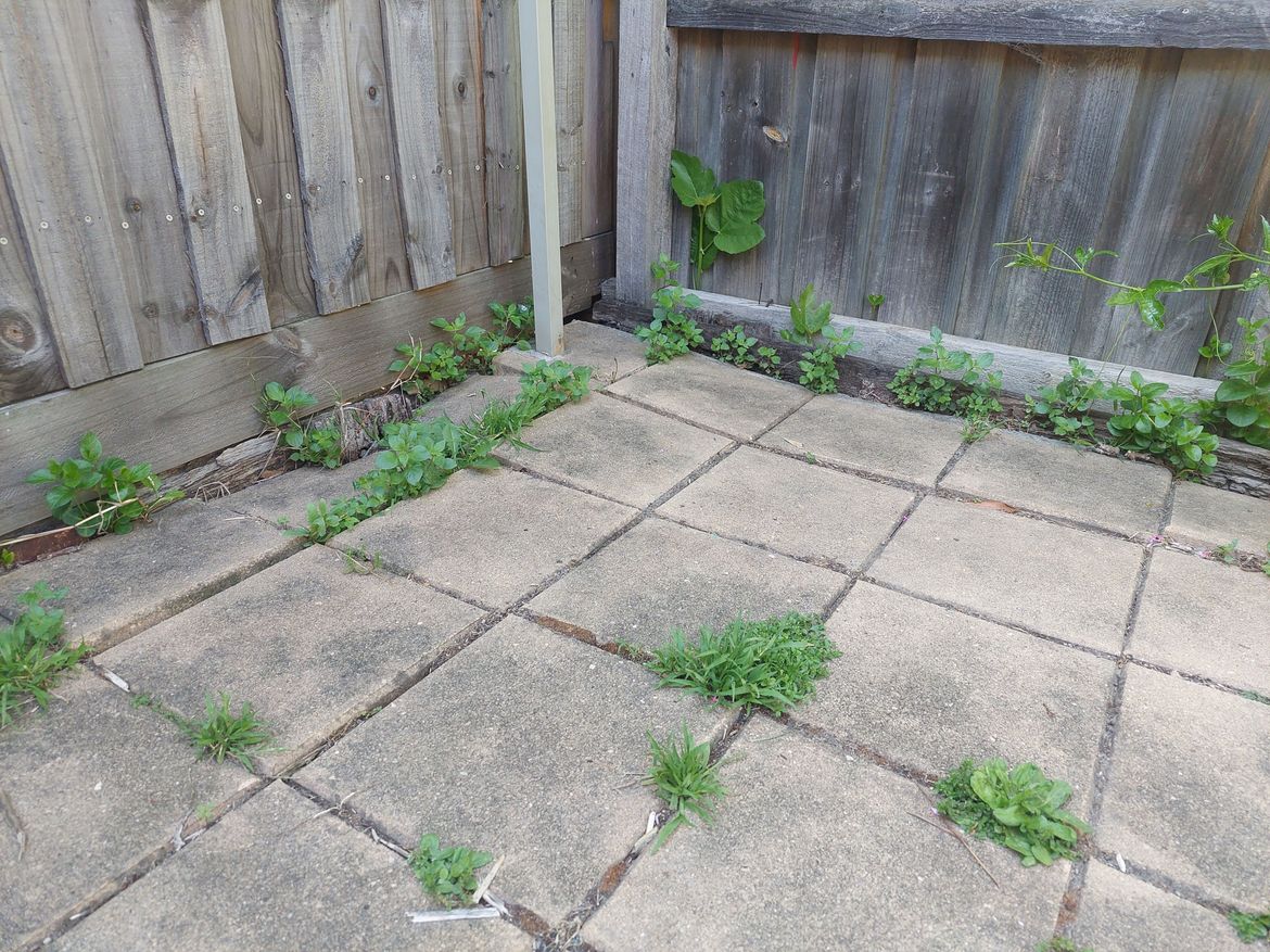

And this is an example of the pavers:
Hello @TaraL
Thanks for sharing your question about building a low-level deck on your pavers. Looking at the photo you posted, I believe that it's possible to build a low-level deck in that area. However, I suggest removing the pavers and recycling them for another project. In this manner you can level the ground properly and apply a fall so that water drains away from the area. I recommend having a look at these guides -How to build a low-level deck by @Adam_W and How to build a deck by @MitchellMc. These guides will give you a general idea of what is involved when building a low-level deck.
The best part is that you can use some of your pavers as footing if you're going to be using Builders Edge Pedestal Feet.
Here is a link to ideas and inspiration: Top 10 most popular low-level deck projects
Good Evening @TaraL
Im with @EricL and @Nailbag with removing the pavers to start the project. It will make life a lot easier starting from scratch.
Pavers always come in handy and I am sure you will find something to use them floor, Best part they dont have a use by date.
As the deck will be low, make sure you keep the air vents around the base of the brickwork free so air can circulate.
Something else to keep in mind as I was just going over your photos and design is the base of your fence. Try not to have a mount up of soil next to it as it will speed the decay process for the posts.
I like stirrups in concrete over the pedestal feet, I think its a more solid way to install anything. Its just a personal preferance as both ways are ok.
