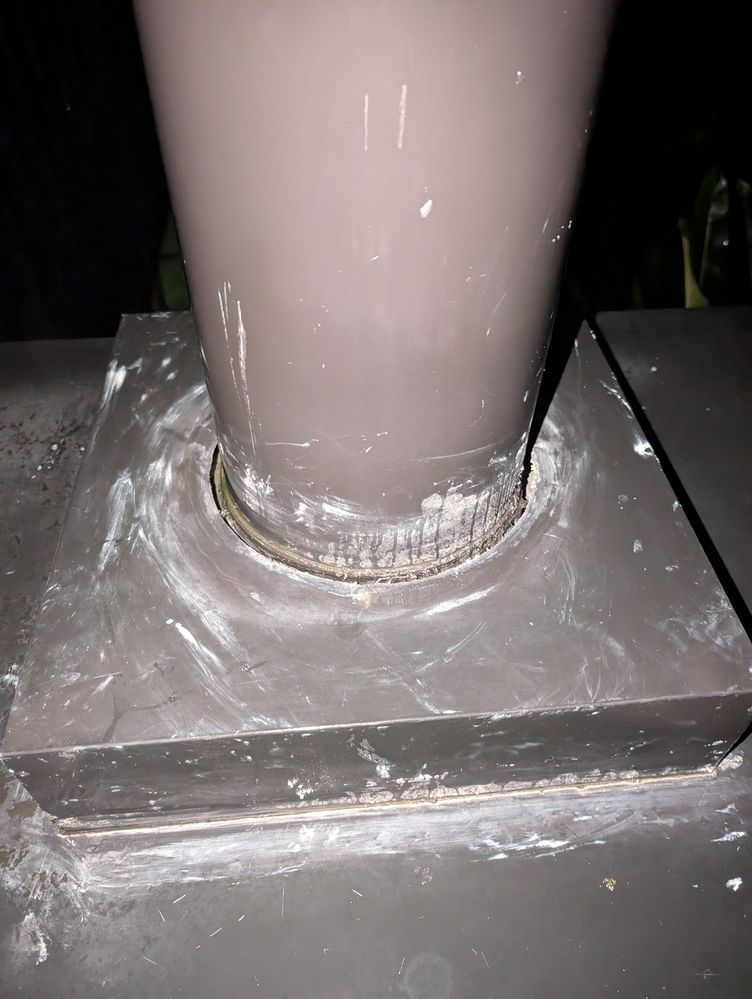

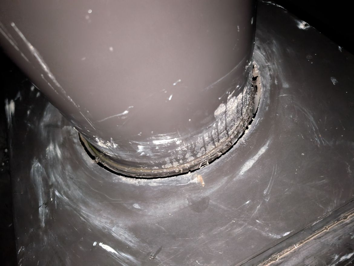

Hi everyone,
Sorry but total novice here. There is a signifcant gap in my chimney, which I believe is the source of leak of rain into my house
I went up the roof and saw that this gap (see attached photos). Judging from the white residual, it looks like there has been some previous work done, but it has been removed or falled off for some reason.
Looking for advice on how to repair this.
Re: Chimney roof leak - how to repair
Hi @loserkite,
A warm welcome to the Bunnings Workshop community, it is fantastic to have you with us,
Typically, for roof penetrations on metal roofs, you would use a Dektite flashing in a suitable size to fit over the flue.
Check out the installation guide here - Dektite.
