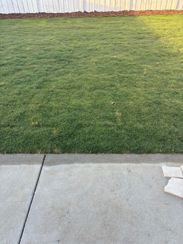

How to lay tiles on slab with wet edge?
Hi there,
have posted previously and now ready to start tiling. An issue I’m having is the edge of the slab we poured isn’t drying out since I’ve laid the grass. It was bone dry before we laid the grass and is fully cured. Seems the watering of the grass and the moisture from the soil is keeping it wet. Can I still go ahead and lay the tiles? If not what can I do in this circumstance?
thanks.
