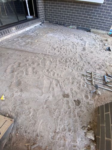

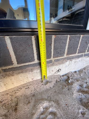

wanting assistance on a deck frame ive got about 200mm to work with before i have to start excavating,
deck is 3.3m x 8m

If you were to build a traditional decking frame with bearers and joist 200mm of usable space would not be enough. For example, if the bearer was 140x45 plus the joist at 90x45 along with the decking panel of 19mm you would have a total of 249mm. You would have to dig deeper into the ground just to fit the frame. Even using a 90x45 for both bearer and joist would still not be enough as it would be touching the ground, and you would not have an air gap. If you were to use 70x45 as joist the air gap would be too small and would impact the airflow under the deck, plus it would severely limit the type of footing you can use for your frame.
I propose looking at the single layer frame for your project as it will not occupy all of your usable space under the deck.

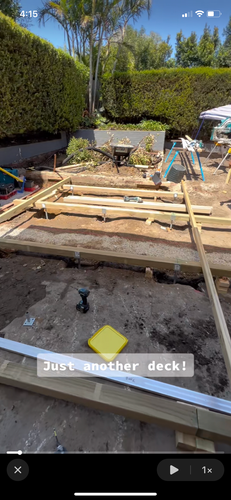

 this deck frame looks to be pretty low I was thinking bearers look to be something like a square 100x100 post
