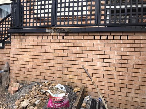

Going through looking at the photos I was wondering where your air vents for the back of the house/brickwork are? If they are above your concrete patio will they be blocked by the added height of pavers/tiles you want to use?

I've placed an image below to give you an idea what the brick air vents/weep holes are and where they might possibly be located. Typically, builders place weep holes at the bottom of brick exterior walls. They look like vertical gaps in the mortar joints between bricks. As gravity pulls water down to the bottom of the wall, the weep holes allow water to exit just above the foundation.

:smile:lol they are nothing usually to think of twice. Some houses have air vents in teh brick work to allow ventilation of the underneath of the house. These are just vertical slots usually around the last course of bricks near the floor level. Think normal space of briscks next to each other and then a gap of 1cm then brick and another gap of 1cm. These are spaced around the house for ventilation. If you dont have them then no worries.
You can see the airvents on the walls in these photos. They are just below the floor level.
