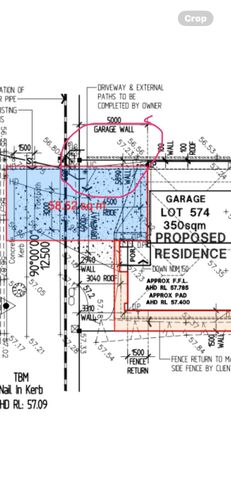

I'm looking for suggestions on how to tackle the sloped area between my fence and driveway, especially since there aren't enough retaining walls to stabilize the soil. Should I build another retaining wall next to the current ones?

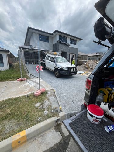

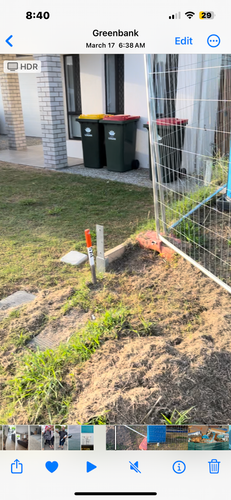

Just to let you know , The retaining wall is already there . Please have a look at the pics.
The issue is if the existing height of retaining wall is good enough or not.
Builder can’t wait and won’t allow any other person to go and increase the height of existing retaining wall.
what is the way to check of the height of existing retaining wall is good enough or not?

The height of the retaining wall would need to be level with the surrounding soil @Salam123. Is the current height of the soil above the top of the retaining wall?
Provided the retaining wall is in place and it has been engineered to withstand the additional weight of the concrete drive and cars, you should be good to go with bringing the drive up close to it.

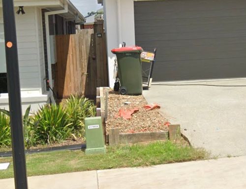

it looks like to me that the best solution would be to keep around 500-600 mm gap between edge of driveway and existing retaining wall. Once driveway is made then increase the height of retaining wall if required then backfilled so that it looks something like attached file .
Re: How to fix sloping gap between fence and driveway?
Hello @Salam123
That's exactly what I would recommend, the added flat surface can serve as a parking spot for your bins.

 the final solution implemented is here
