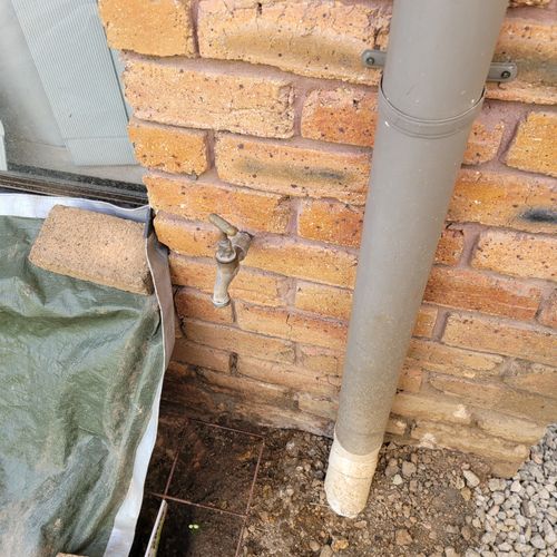

We are trying to pressure wash the foundation before waterproofing it like what @MitchellMc suggested
We finally have time to finish off this project we have bought all the materials we excavated too
