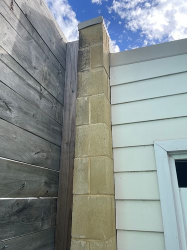

Hi @EricL
Any suggestions for removal of;
1. The black staining at the top of the blockwork (assuming this is something/rainwater running off the capping?) this is present at other areas of blockwork around the house as well…
2. The general blockwork face needs cleaning, some dags also present, but mostly just mortar.
Many thanks in advance.
Cheers
Ewan
Re: How to clean mortar stains off brickwork?
Hi Ewan(@ER1),
Mortar dags can fairly easily be removed with a chisel. Hold the chisel at an acute angle to the block and run it along the surface of the block to hit the join between the mortar and the block. With a minimal amount of effort, the mortar should chip off the block.
Once the dags are cleared, I'd suggest using a pressure cleaner to clean the blocks.
It looks like the dark spots are just dirt deposits from dripping water, so they should be fairly easy to remove, but if they are a bit troublesome, using some Gerni Concrete And Stone Cleaner should help with their removal.
