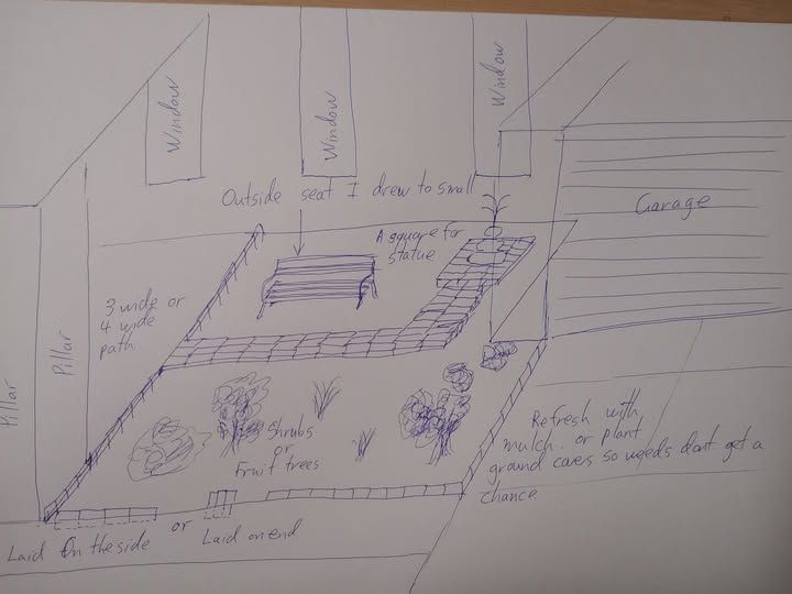

So I was thinking of a small width path to go to the religious statue. 3 pavers wide or 4 depending (Kept it small as its not a large area overall)
The "edging" can be pavers laid on their side against the concrete and then nackfilled with mulch to hold them in place. or stood on end if you want a little higher edging. These will move over time but I figure you will be mainting the garden as you will be activly using it. The edge pavers make it so you can adjust things if wanted.
The outside seat, should be maybe half as wide as the whole area.
The high side I was referingto is the windows, the low side the path at the front.
Tools, whoops I forgot to include a small spirit level!
The path can be anywhere along the area really. Maybe start with placing the seat a little off the wall and then figuring the path?
Id go for shrubs either side of the garden and lower groundcover style ones in the middle so you will always have a view
