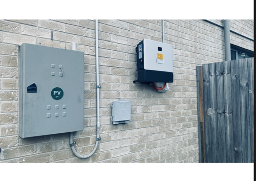

hi Guys,
Recently I have got solar installed in one of my investment property.
It is sungrow 10.56kw. This is my solar inverter.
The inverter is outside the house. The house is double storey house.
I would like to put something to cover the inverter from rain and may be direct sunlight as well.
Are there any ways to make and install cover that are not very expensive.

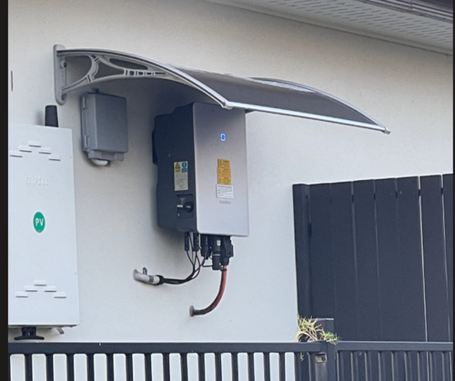

And I also saw someone using above product :
This is little cheaper, but when the rain comes from side, it may not block rain at all.

A premade canopy such as the Altamonte 1200 x 700mm Siena Tinted Canopy With Plastic Bracket seems like a good, cost-effective option for protecting your inverter from above.
Due to the IP65 rating, there is no real need to protect the sides from rain, but if it fits within the manufacturer's specifications, you could build a screen for each side from 70 x 19mm 2.7m Pre-Oiled Merbau Solid Screening or use a premade panel like this SpecRite 1800 x 600mm Pre-Oiled Merbau Garden Fence Panel to block a lot of the driving rain.
