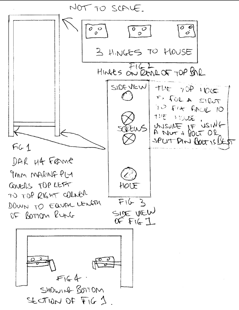

Hi All,
I'm still procrastinating on the window coverings, but after last nights wind, I think it's best to look into them seriously. So, what I have come up with is this, I hope I can make it simple enough.
I will try to draw an image by hand but this seems to work in my head, no doubt there's something I've not thought of? I'd appreciate your input, please.

Hi @BoeingFan,
Having joined the conversation late in the piece, I reviewed everything up to this point and can't see any obvious holes in your plan.
Once you've uploaded an image of your plan, it might be easier to see anything that you might have missed.
Let me know if there is anything else I can assist with in the meantime.
G'day @JacobZ
Forgive the hand drawn image, I don't have any fancy software
Basically it is a rectangle frame, with the lower bar about 3 inches up from the end of the side bars. This is to facilitate holes for sliding bolts. The issues here is that I don't know if the slide bolts will be too flush with the house and the hole required in the side bars will be nearly right to the edge. I could always put spacing blocks behind the bolts but it's not as neat.
There are two screws in both side bars to secure the lower horizontal bar. Just above those two screws is another hole which will be used to secure a timber strut running back to the house. Having something strong but removable here is required, be it a nut and bolt, or preferably something I can do up and undo without any tools would be ideal.
I'm thinking that H4 DAR beams will do the trick nicely, and the marine ply will fit squarely over the top left to top right, and down as far as the bottom rung.
Then I will caulk and paint it. This is a window cover for shade and also closable for storms.
I hope you're well buddy!

G'day @EricL ,
I checked out Jason's how to choose the right timber page, and decided that H4 might be the best option to choose given this is an external covering, potentially exposed to significant rain events. I am going to paint it, this is true, but I found it difficult to find any appropriately sized DAR H4 at Bunnings. They seem to be all square or round posts etc.. This H3 Outdoor Framing Timber is the size I'd like; do you offer it in H4? If not, can H3 be painted, is it DAR, and is it an appropriate level of treatment for this use?
