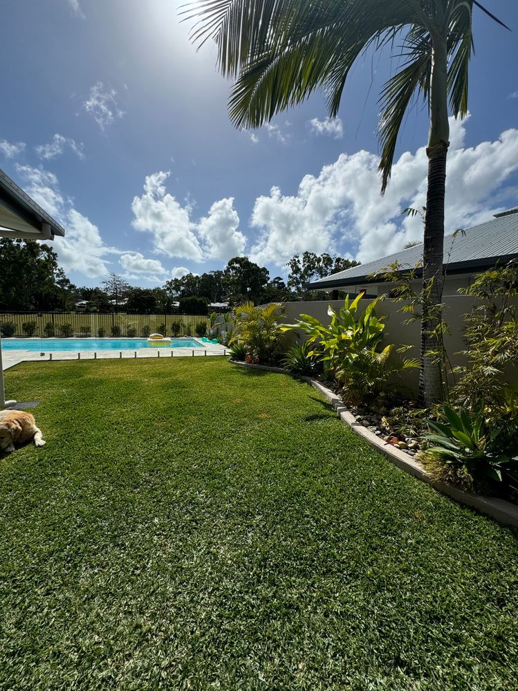

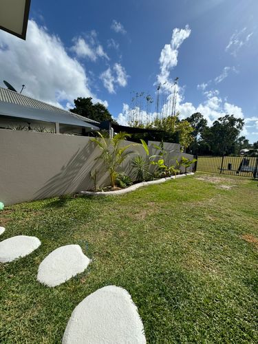

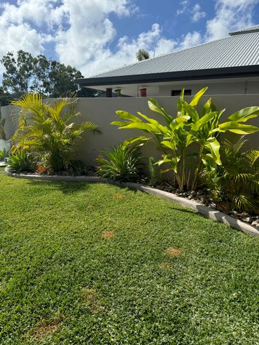

first we mixed up the concrete at a ratio of 6/1
marked out our curved edge using marking paint
placed brickies wire along the curve
carefully shoveling on the mix and using our hands with gloves on to mould the concrete around the wire into the shape we desired.
once dry I painted with duluxe exterior house paint
