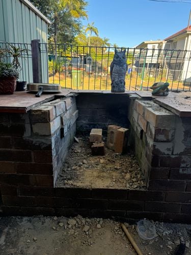

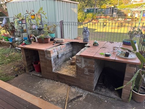

I’ve inherited a partly fallen in old brick table/firepit area in our garden of “varying” quality. There’s a void in the middle which has previously been used for burning garden waste but I’d love to make it into something more appealling.
1) idea one was to convert it into a pizza oven by building a slab and arched roof using discarded bricks from the same source (the whole apparatus was repurposed brick originally) but I don’t want to spend crazy amounts - anyone got experience of what would be an economic approach to doing this?
2) other ideas welcome 🤗 just building a bench top across the voice probably easiest but not that exciting.
available “free” materials = big pile of bricks with various bits of mortar attached

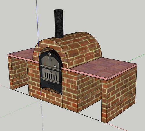

Loving the ideas - as it's very much a 'make the most of something that's there' I'm wondering if finding one of the many second hand ovens on facebook in this sort of style https://www.bunnings.com.au/jumbuck-torino-woodfire-pizza-oven_p3180885 and then building a upcycled brick surround might be a good economic approach. I like the IDEA of going the full hog with firebricks or one of the kits but it jumps rapidly into being a proper investment 😝
Very quickly mocked up but something along these lines... (lots to resolve - how to prevent water ingress around chimmney, would heat be too much for brick arch if not firebricks etc)

Now that would be sweet! Adds a whole range of options doing it that way. I would still recommend firebricks surrounding the oven as normal bricks will crack with heat up/cool down. Do you know what your side benches are made of?

Still saves a bit I guess @Dave-1 - or I can do v1 reclaimed and see how long/badly they last 😂
Side benches are brick with some sort of cement board and tile on top I need to measure properly but depending on the pizza oven in the middle there should be 70mm or so air gap around... I suspect it'd get very toasty though!

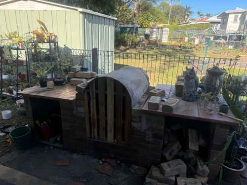

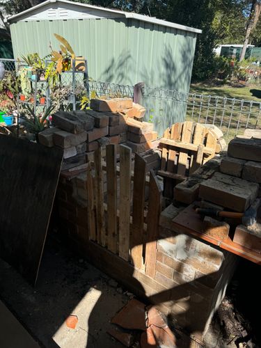

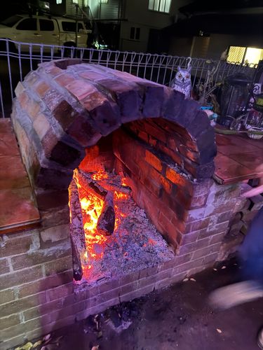

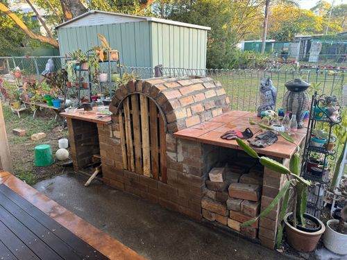

Following on all the advice, I went ahead with our “cheap but appropriate for likely usage” option upcycling the bricks, building a sacrificial arch support from pallets and plywood. The brick work is definitely a learning experience and I knew the finish wouldn’t be perfect 😂
Everything survived the first fire nicely and the support burnt away as planned.
upgrade plans:
- tidy up mortar
- some sort of split door to contain ash and control air flow
- mesh on the chimney to catch airborn debris whilst letting smoke out
- probably some sort of internal shelf and we can experiment with cooking

Hi @kitfriendesq,
Thank you for sharing the update and congratulations on your newly functioning pizza oven. You've done a brilliant job,
Please keep us updated as you make your upgrades and please don't hesitate to reach out if you need further advice.

Afternoon @kitfriendesq
Now that is an oven! love it and you could cook a whole sheep in there!
It looks so warm (freezing here atm lol)
I do like how you have that edge for a shelf Nice forward thinking and I really like the curved arch brickwork. Are you planning on build a grill for the fire to rest on? (To give it air to breath)
Would be perfect in this weather!
Thank you for the follow up pics
