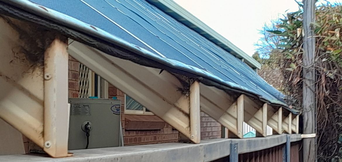

I gave up on the idea for my home, but I did pave down the sides of both sides of our home. I went a slightly different way, and put up a large trellis which I married up to the bedroom windows that needed the shade and privacy.
I will include some closer up pictures of the neighbours shade cloth cover down on their side of their fence. I couldn't go the same way as they have already taken up the entire top of the fence so I would have had to have altered part of there set up, which I didn't want to do *(didn't want neighbour issues) I also still wanted access to my gutters from the ground to be able to clean them out as both neighbours have very large trees and I am constantly cleaning out my gutters because of them both.
I should have this issue too badly, soon as we are moving. So starting all over again. with only back neighbours with large trees.. *(ummm).
I hope the attached pics are of some help, and if you or anyone else are interested and need more pictures please just ask.

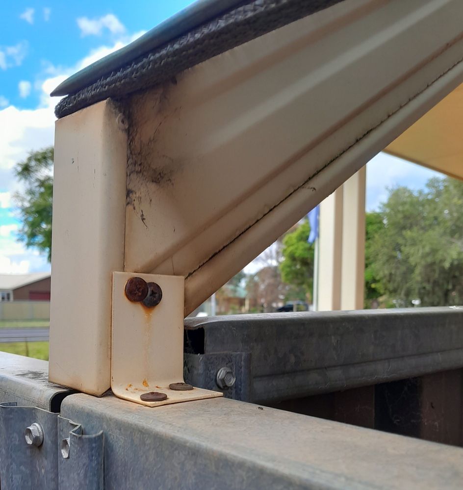

This Old-GalBracket attaching to fence
Looks a little like a Joist Hanger/bracket to facia

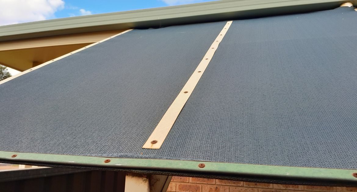

Metal strip folded over edge of shade cloth
Metal exterior strips holding down on supports
As well and pining it to the support
