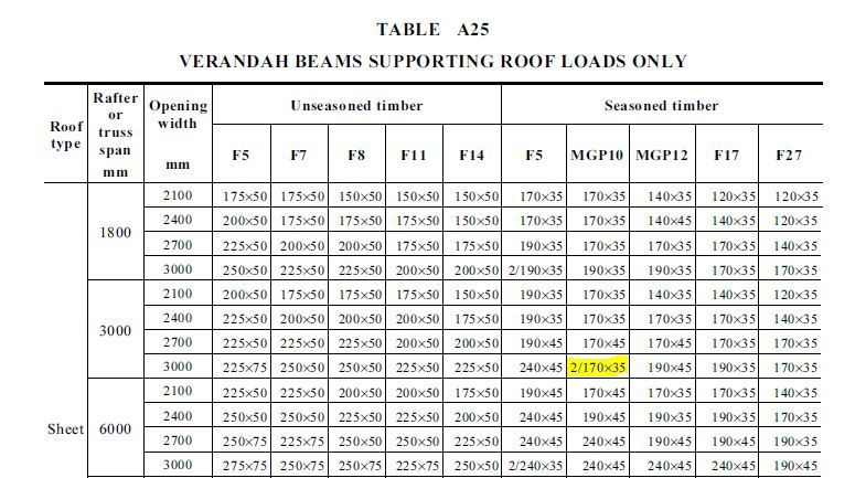

Regarding the opening width between each posts, I want to keep them 3 posts all together over the 7m length of span. that means I will have around 3500mm opening width between each posts. According to the span table, they biggest opening I can find it 3000mm, and it suggests to use 2/170x35 timber.
Can I use one 190x45 timber for 3500mm opening width?

Unfortunately, I wouldn't advise you to go outside of the recommendations of the span table you've linked to.
I have found in the Woodhouse Span Tables that a 185 x 42mm F7 H3 Treated Pine Primed LOSP can span 3920mm with a roof load width of 600mm.
This is likely a good option for you.
Outside of this, large spans often require engineered timber products known as LVLs which can be ordered from a few different suppliers including Wesbeam, Dindas Australia and Tilling Timber through your local stores Trade Desk.

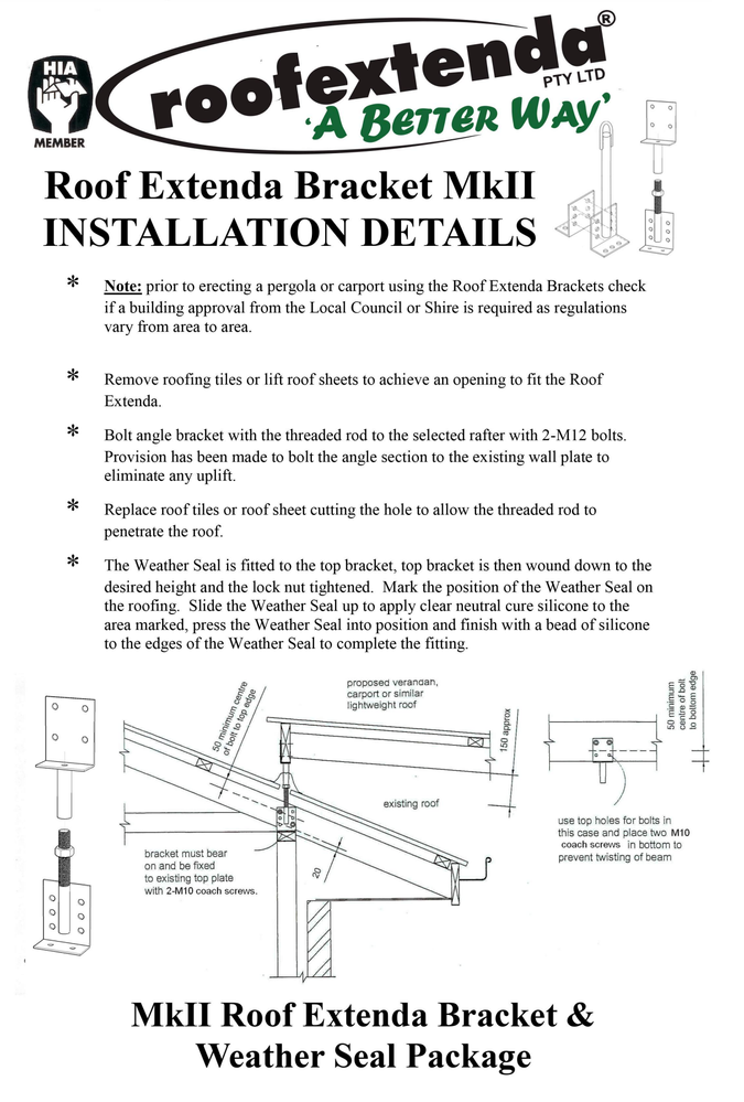

For the waling plate what is the minimum timber size I need to use? There are two sides of waling plate will be attached to the current rafters behind fascia board. The height of current fascia board is only 100mm, Can I use 120mmx45 timber across the 7m length for waling plate?
Option 2 for me is to use MKII roof extenda bracket. However, I need to have a fully close ceiling so might need to install another beam just against current gutter? How's the flashing and waterproofing can be properly done that way so no water will be coming into the ceiling in the future?

It's difficult to provide exact details on the required calibre of your wailing plate, and this is really in the territory of needing an engineer or builder to specify. I would suggest contacting one of them for more information and recommendations.
Extenda brackets come with their own weatherproof seal that prevents water from leaking through the opening that has been cut for them in the roof.
