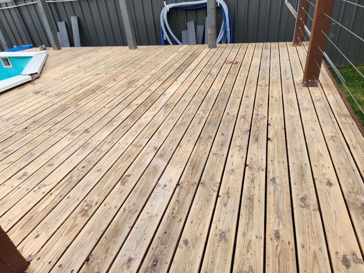

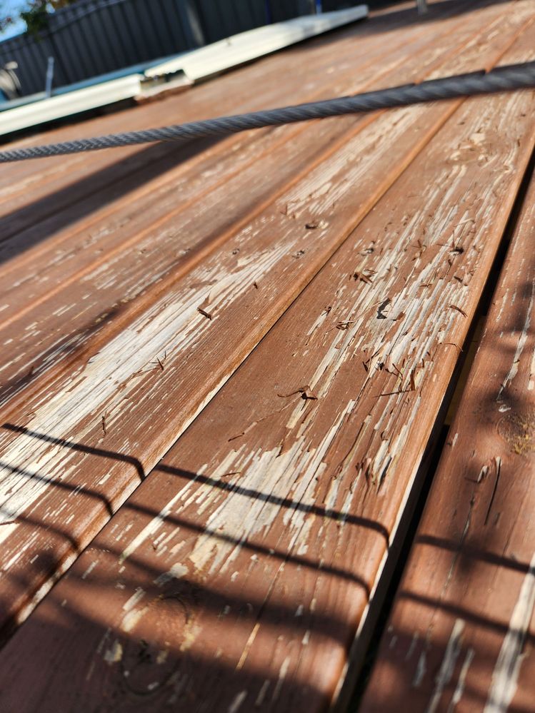

So, some of you may have seen a previous post asking 'how do I fix my deck?' You folks had some awesome suggestions for which I thank you. I stripped the old stain off with Intergrain timber stripper which worked really well (also learnt it is very slippery). Then cleaned it off with my Karcher, although this did chew up the wood but just a little.  Then, following your advice,  I hit it with 80 grit followed by 120 grit, my palm sander and my new toy, the orbital. It's taken me awhile (can't physically do to much) but I'm very proud of myself for what I achieved. Now hopefully the weather will be just right tomorrow for the first coat of jam.

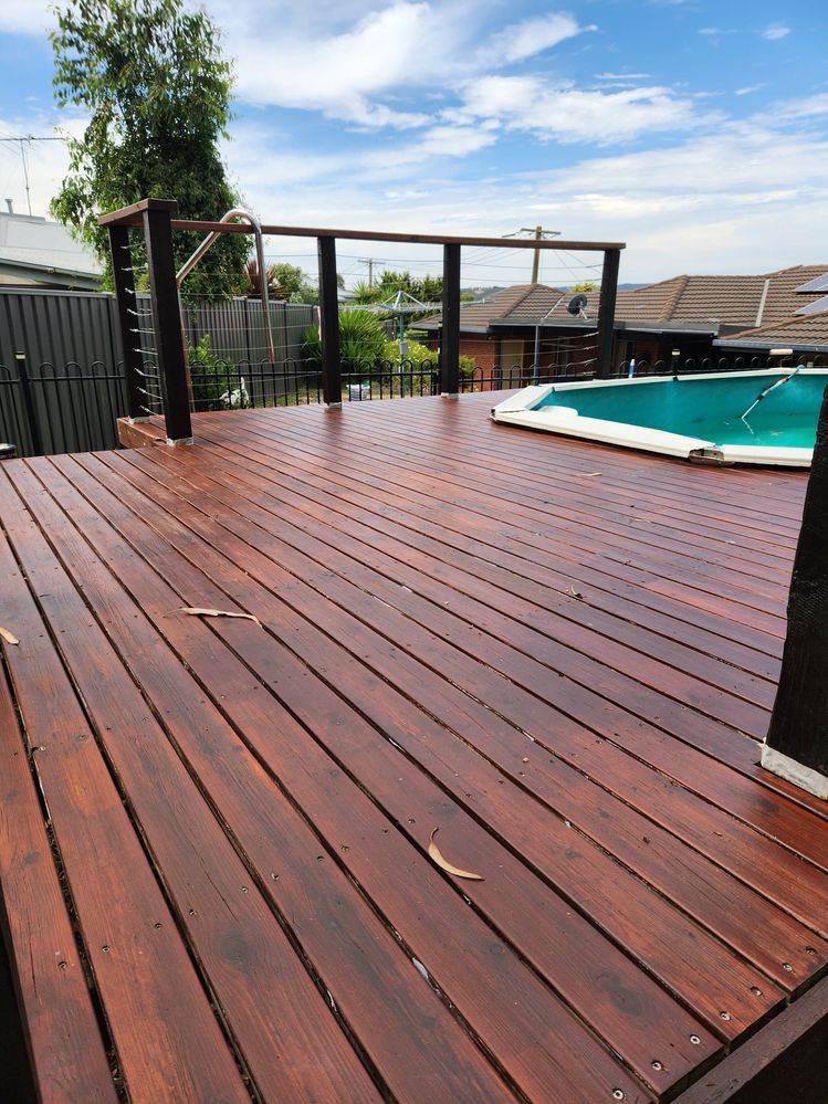

Good morning bunnings  workshop  community.  Well, if you've  seen the start of this project, you'll know it's taken a long time to finish. Finally,  the  weather was just right. The  2nd coat is done and dusted. It may not be perfect but then neither am I, but I'm very happy with it. Thank you to everyone that helped me with ideas and how to does. Very much appreciated. 20230116_150305.jpg

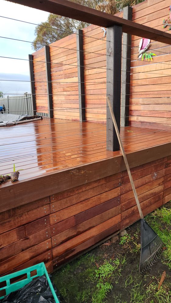

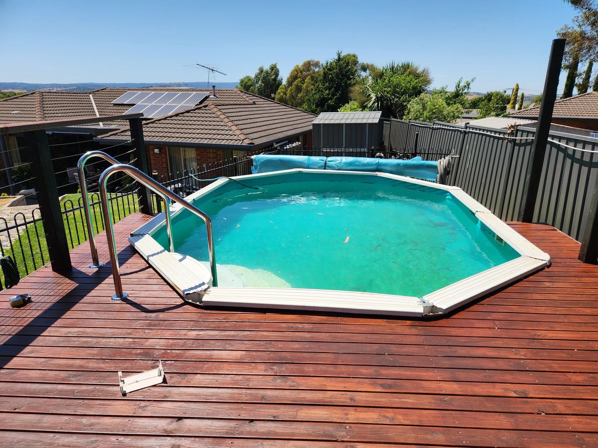

Some of you may remember my deck project last summer where I was asking advice on how to do it.  Well,  just thought I'd put an update photo of where it's at.  It's nearly finished (need money)  but I'm very happy with what I've achieved.  I can only do what my health allows so it's a slow process.  Hoping to restain the steps and attempt to put some deck lights in (might be back for help with that) then finally some plants and furniture,  all by summer..... hmm
Re: I'm still doing my deck
Hi @Jeanagh
Thank you very much for posting that update. Your deck is looking fantastic and I'm looking forward to seeing it once you have the plants and deck lights in place. There are a few models available some with colour changing features and others that are solar powered. If you're feeling up to it, I suggest visiting the stores electrical department so you can see the latest models available.
