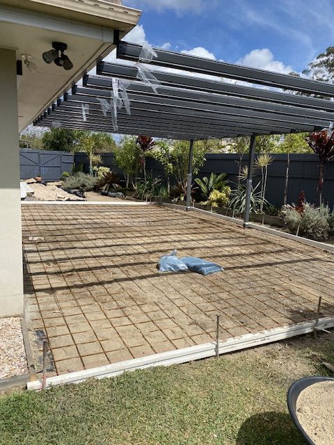

which we love the look of. We need to know the best way to adhere these to the concrete once it is dry? It is a big area and we will be doing this ourselves so any assistance would be greatly appreciated. We have already brought the pavers.

Our area is about 53m2 (9.5 meters by about 5.5meters), it will have a roof and screens (flyscreen only) so no necessarily will get too much rain or water. So adhesive and grout options for those conditions please.
