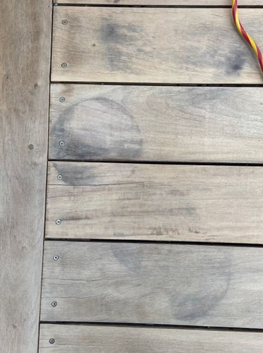

Hi. I sorted it finally. Still unsure of what to do about when I need to stain about the spa being in the way. Photo attached. The deck is made of Kwila.

As @Jason has mentioned, could you please provide more detail on what you want to achieve and why you want to strip the natural colouring out of the timber? Is this a new deck and you wish to strip the tannins out of it before oiling it?
Is this the permanent location for the spa? If not, then I would wait until you can have it moved. Before them moving it, I would suggest oiling the area of the deck it is moving to and then placing the spa into position. You can then oil the rest of the deck around it.

I think your best option would be to have it moved off the deck for a few days whilst you strip the tannins and complete the oiling process of the deck. It can then be placed back on the oiled section when you're done.
Is it empty at the moment? If it is, I wouldn't have thought it to be incredibly heavy. Perhaps a couple of neighbours could lend a hand with some encouragement from a six-pack of beer?

Not that easy but thanks. Weights 246kg empty.
