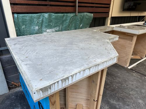

I’ve attempted to pour a concrete bench top in place for an outdoor kitchen.
it’s being curing for the past week and it’s time to get polishing. Or so I thought.

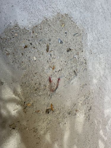

I’ve gone to hit it with some 80 grit sanding pads on my orbital sander to smooth some rookie troweling marks but it seems to be tearing at the surface. It’s not smoothing it’s making very gritty.
I used a pre mix sand and aggregate mix from my local landscaping supply, and dingoes Cement, Davao Lanko 311 Plasticser and Dulux Avista white oxide. All based on a 3,2,1 mix.
any thoughts or advice?

Hello @Mitch31
I suspect that the surface of the concrete is too soft and can't withstand the low grit count of the sandpaper. I suggest using 240grit sandpaper to see if the surface can withstand the sanding process. If it still strips the surface, it might be necessary to render the surface with high strength concrete.
If you need further assistance, lease let us know.
Re: Concrete tabletop project
Thanks @EricL
I felt like I used more cement than not enough in my mix, is it likely it hasn’t hardened enough yet?
I’m going to attempt using diamond grit pads on my angle grinder, see if that helps cut the sand particles and aggregate rather than rip them out. Unfortunately Bunnings don’t sell them 👎🏼
Worst case, do you think if I make up a cement only smooth coat type and trowel that over the top?
thank you!
Evening @Mitch31
I havnt had a lot of experience with sanding/grinding concrete yet I think when I did the concrete repair on my patio it was going to be weeks before it had reached full strength. Id be tempted to wait a few more weeks for it to harden. Other then that The render suggestion of @EricL sounds like a good plan B
Hi @Mitch31
Personally I would avoid using anything aggressive powertool related. Though your project is outside my area of expertise, I would consider a 80-120 grit flap wheel on your grinder with very light pressure.
Nailbag
Hi @Mitch31
Doing a smooth surface coating is definitely an option and I would not rule it out. But I would put that at the very end of your list and suggest trying out your diamond grit pads and see if you get better results.
