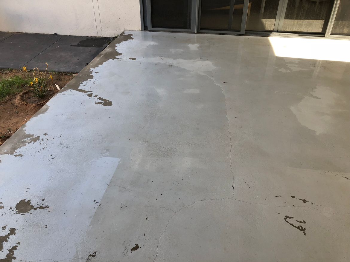

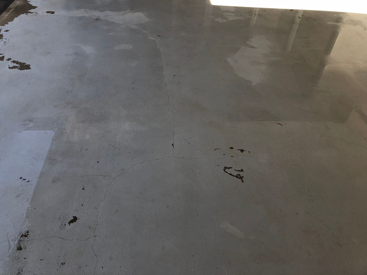

This is my first painting job it’s my alfresco floor need to repaint. I chipped lose paint with wired brush and scrapper then put degreaser then wash with water gun. I need to ask that where I scrapped , do I need anything under the paint? And how to paint step by step please. Also when I wash with pressure gun some paint chipping when I brought close. Do I need to take whole paint off as Bunnings guy told me to put it over.

Hmmm. Really depends on how well the current paint is binding to the concrete whether to get it off or not. If its flaking off really easily then I would get rid of it all otherwise you risk the next coat just flaking off too.

Thanks for that @Goldy, I think your answer is there on the can. If it is not sound, remove all paint. It's not going to be a fun job, but really the only way you can guarantee a strong bond to the surface and that you don't have to do all this again.
