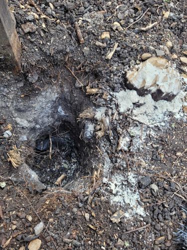

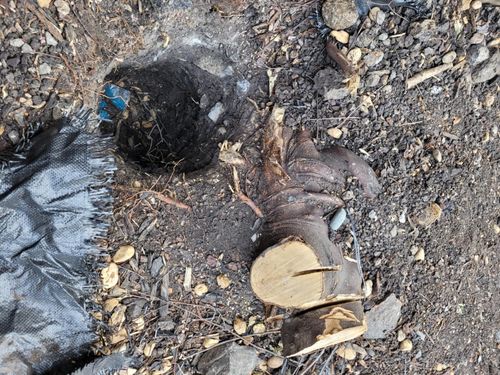

I am looking at building a retaining wall in my backyard, and I am wanting to get some advice. For clarification, I have already dug the post holes and my next step would be pouring the concrete and put in the posts.
1. Some of the holes for the posts are directly next to tree stumps. If I fill the holes with concrete, and the tree rots in the future, will the retaining wall move?

If your post holes are directly next to tree stumps, future movement could occur if the stumps decompose and cause the surrounding soil to shift. To prevent this, it’s important to ensure your posts have adequately sized footings. At least 1/3 of the post should be in the ground, and the footing should be wide enough to provide stability even if the soil around the stump shifts.
