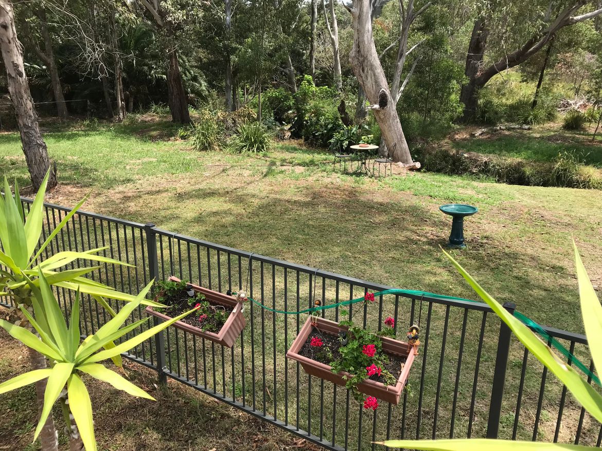

9 dead trees just in this pictureSomeone, of doubtful parentage, had copper nailed and ring barked a few of the once beautiful native gums. The vandalism did not destroy all of the bush setting but as you can see in the photo we have our fair share of dead trees, bordering the creek.
I counted more than 14 dead trees, and formulated a plan to replenish the area with 20 trees, significantly less dead ones, as well as cut down a few of the more prominent deceased ones.
The first thing to do, before cutting down a tree, even or perhaps, especially a dead one, is to watch the tree closely to see just who might be living in it. The tree centre photo with the table and bird feeding bowl is home to a nesting pair of Wood Ducks. So it stays.Happy Family
The majority of the others are mostly home to black ants, and cockroaches, so what the heck, down they are to come.
