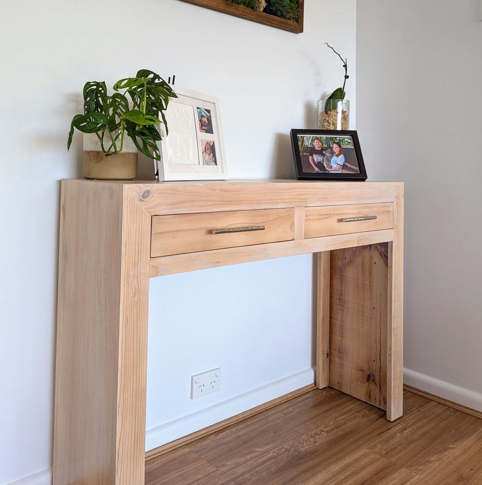

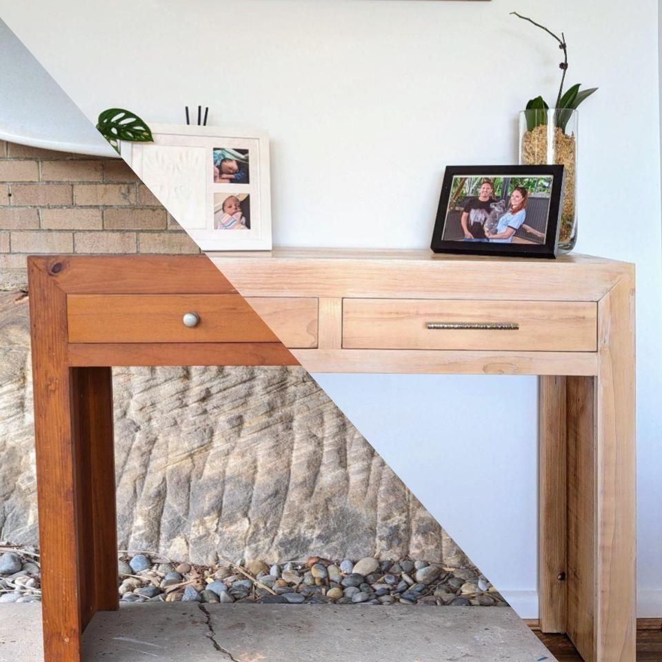

This is a console table I got for free off marketplace and did up for my front entry way on the cheap. A couple new techniques for me:
1 - It was my first time using a tan wash to highlight the natural character of the wood, while removing unwanted yellow tones
2 - It was my first time using peel and stick wallpaper the line the drawers and give the piece a bit of extra colour
I'm thrilled how it turned out, and wanted to share

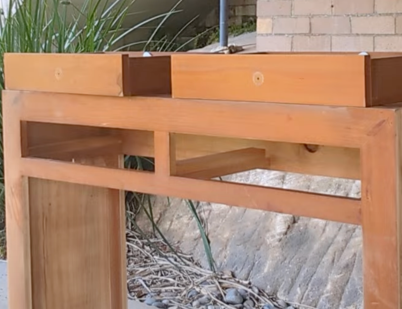

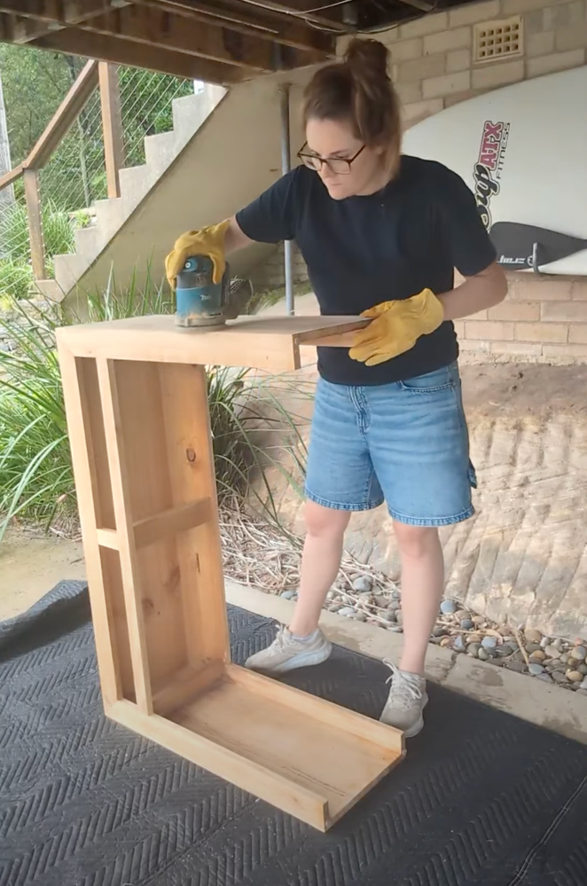

1/7Clean, remove hardware, and rough sand
I removed existing knobs, gave everything a good clean and did a rough sand all over to remove the existing finish.

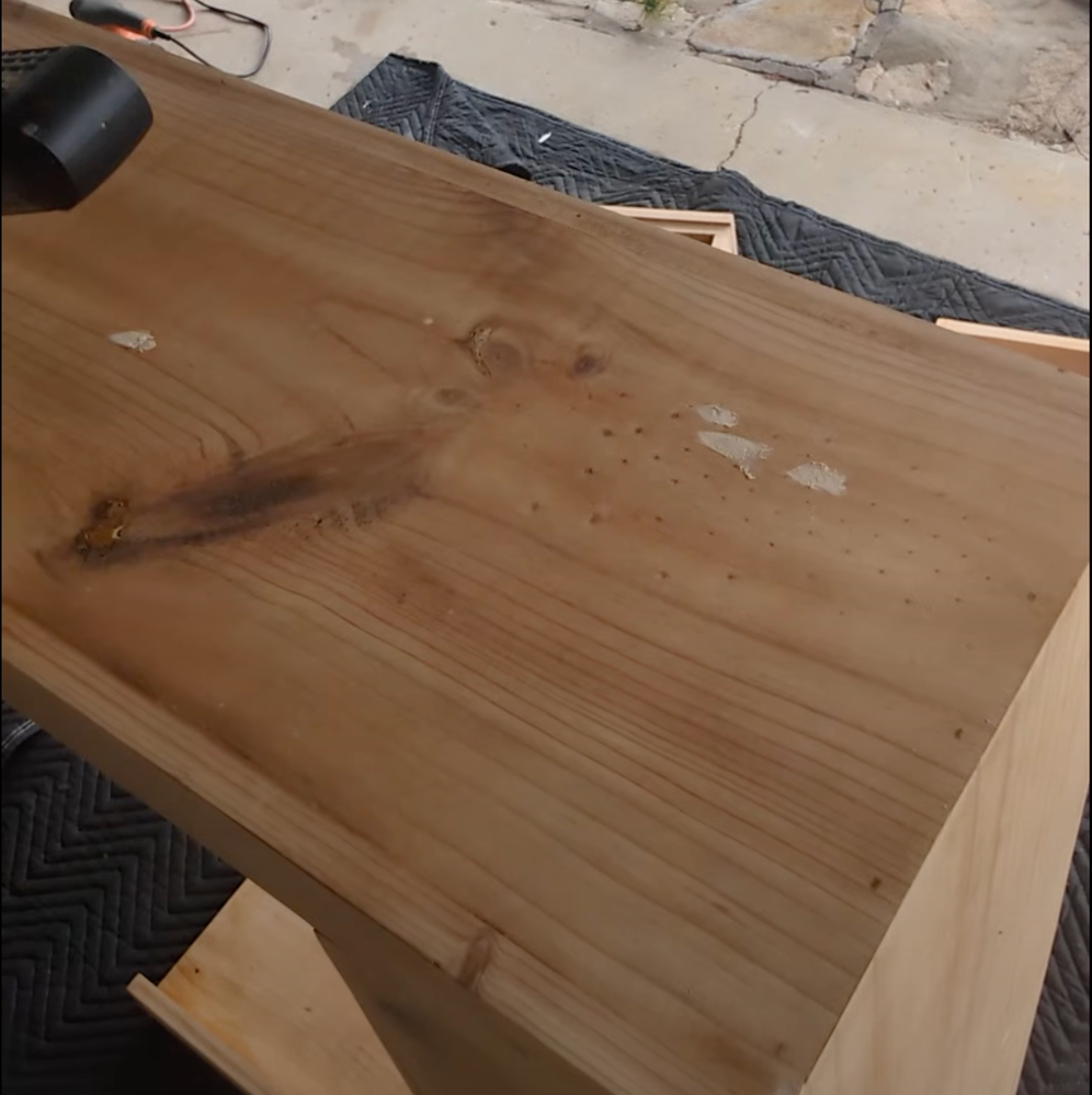

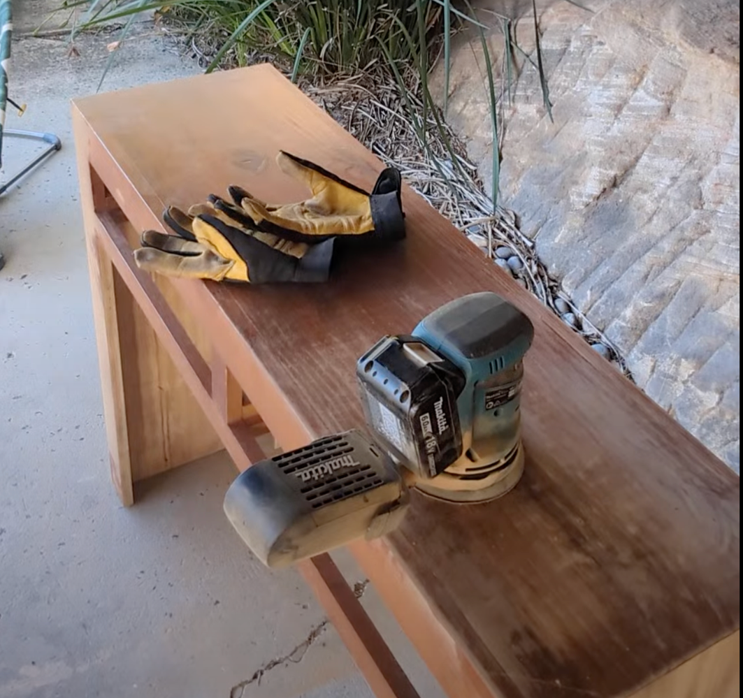

3/7Fine Sanding
I gave the whole thing a fine sand so that I had a smooth, consistent surface that would look good with minimal additional layers.
Once everything was sanded back - I inspected the timber. The good news is it had lots of character and I definitely wanted that character to show through. Bad news - the wood was pretty yellow. I decided to do a tan wash to neutralise the yellow but keep the character.

4/7Tan Wash
Next came the tan wash! I bought a sample pot of tan paint and mixed it 50/50 with water, applied with a paintbrush, and wiped off after about 30 seconds. The tan I bought was a kind of cream colour, and to be honest - if I were to do this over I would pick more of a taupe. I was really happy with the finish.

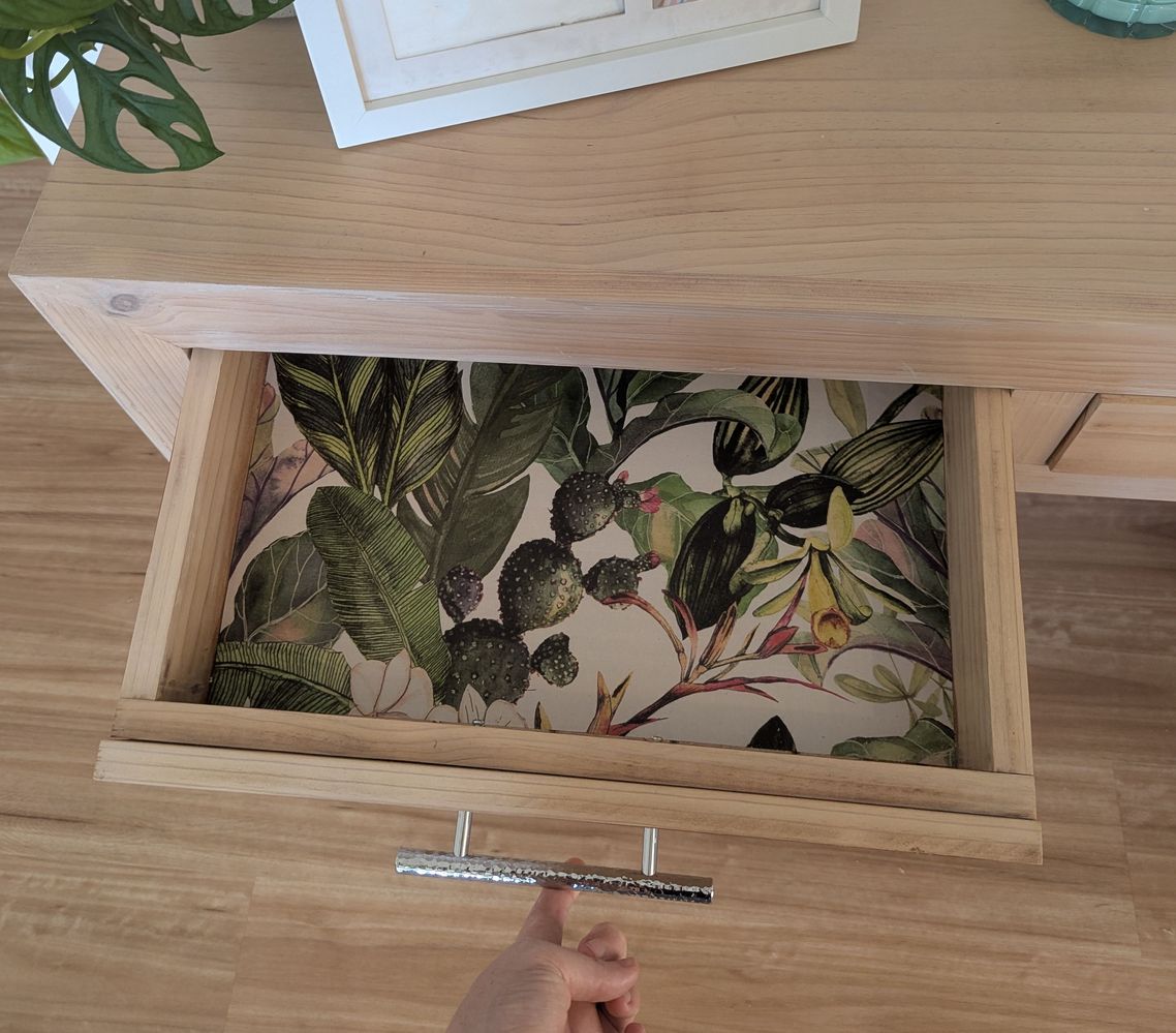

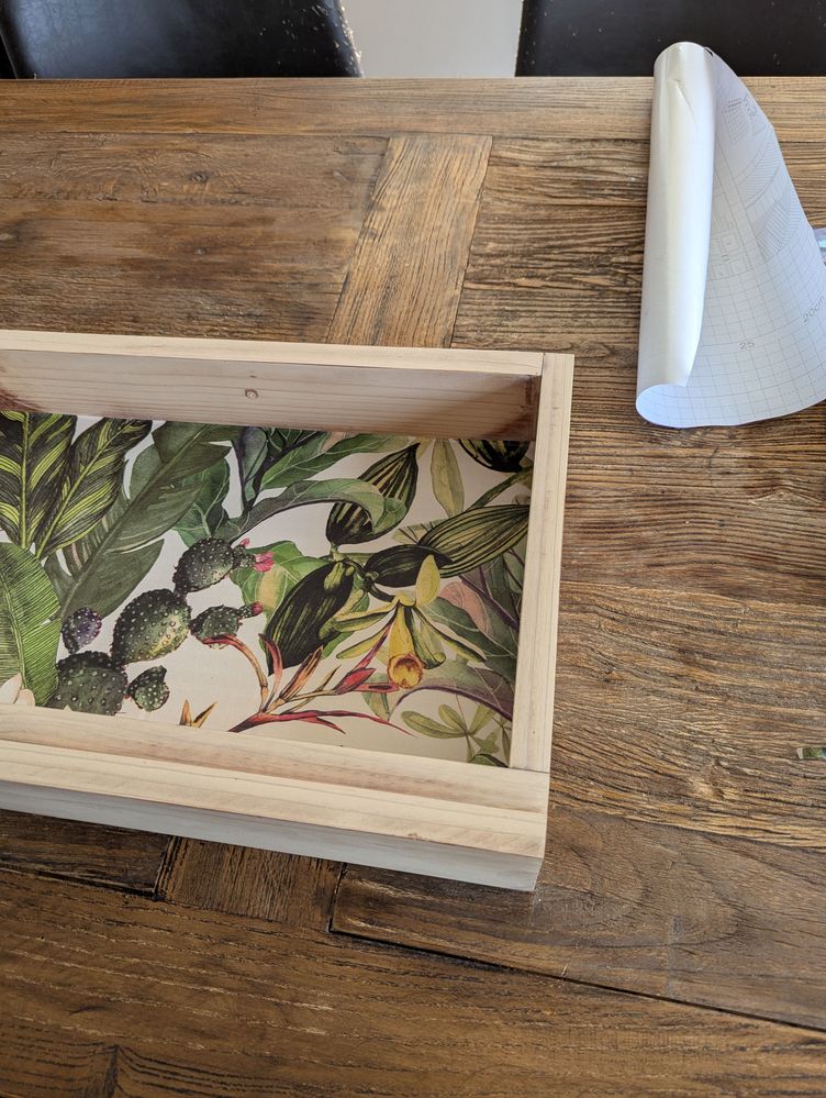

6/7Line drawers
I lined with the drawers with a tropical peel and stick wallpaper that I bought online which I think looks just perfect.

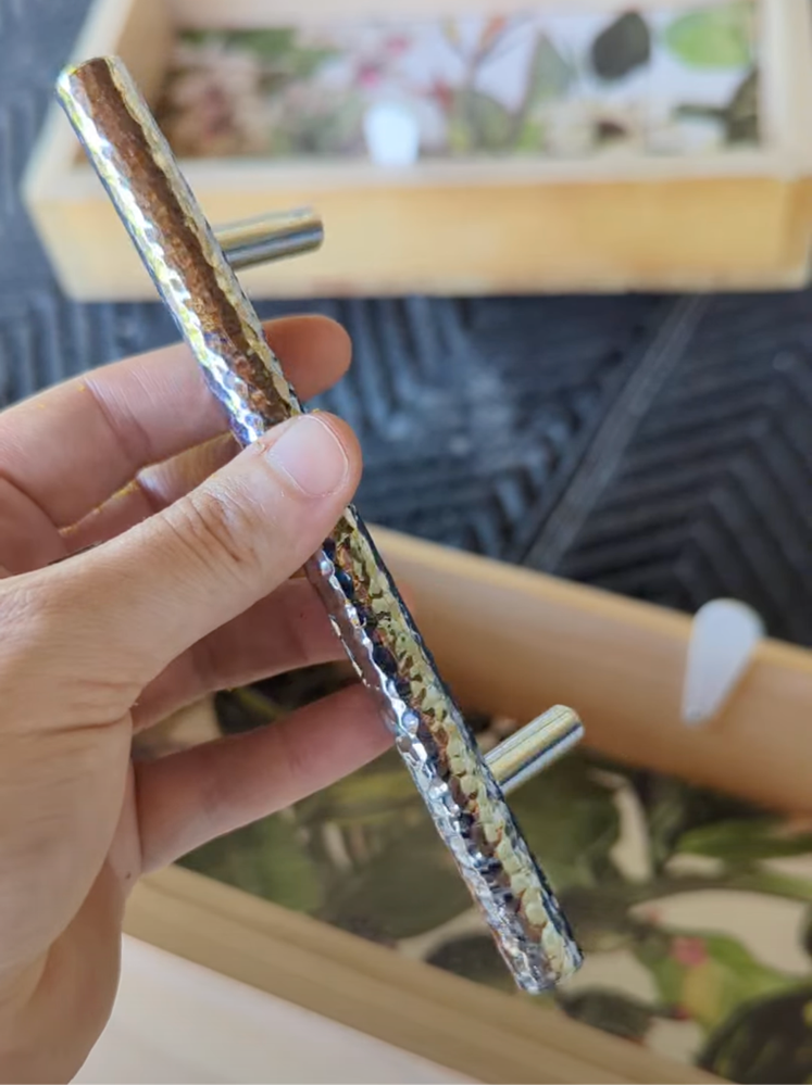

7/7Install new hardware and drawer tabs
Used my drill to drill two new holes in each drawer to support installation of the new handles. I also added in some drawer tabs at the back so my baby doesn't pull these drawers directly onto his head in a few months.
Re: Upcycled console table
Hi @devonlong,
Welcome to the Bunnings Workshop community and thank you for sharing such a wonderful project.
I love the new lease on life you've given this console table.
The tan wash looks fantastic and really brings out the natural beauty of the timber. Combined with the new handles, it gives a tasteful modern look to your console table.
The peel-and-stick wallpaper adds that little bit of hidden quirkiness to the table that really brings it to another level.
This is a fantastic project. I can't wait to see the next one.
