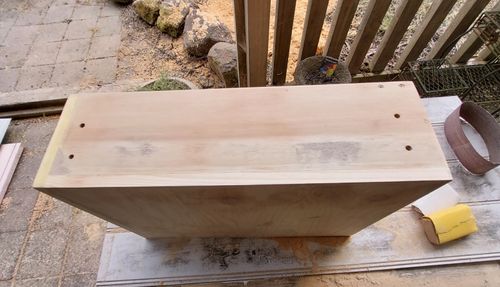

Steps
Step 1

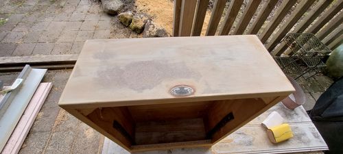

1/3Day 1 - Disassemble, sand and apply first undercoat.

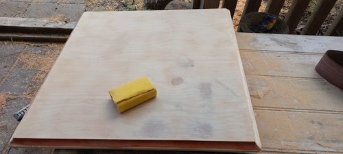

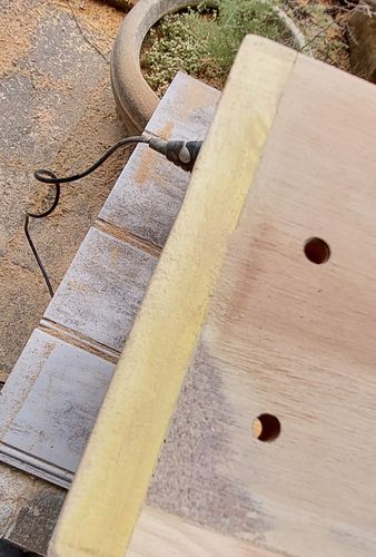

Use 120 grit sandpaper to remove older surfaces.
Wipe down with a damp cloth.

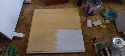

Apply first coat of undercoat - sealer.
Step 2
2/3Day 2 - Apply second undercoat and two topcoats.
Use 240 grit sandpaper lightly before second undercoat-sealer.
Apply second coat of undercoat - sealer.

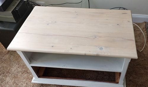

Use 240 grit sandpaper lightly before first stain - varnish.
Apply first coat of stain - varnish to look like wood grain.
Use 240 grit sandpaper lightly before second stain - varnish.
Apply second coat of stain - varnish to look like wood grain.

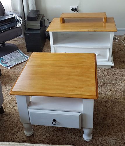

Step 3
3/3Day 3 - Reassemble.
Reassemble legs and tops to frames and refit drawer handles.

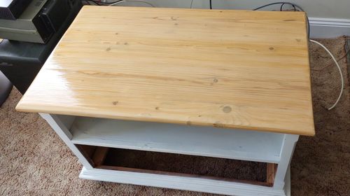

Re: Upcycled coffee table and TV unit
Hello @RJsPlace
Thank you for sharing your coffee table and TV unit upcycle project. The finish on the timber top looks awesome. How many days did it take to paint both units? Any chance of a photo once everything is back in its place and set up? I'm sure our members will be keen to see what it looks like.

Good afternoon @RJsPlace
Thats a nice finish and a whole lot of effort on those benchtops! I really like the idea of reusing what we have instead of buying new
Impressed with the job for sure.
