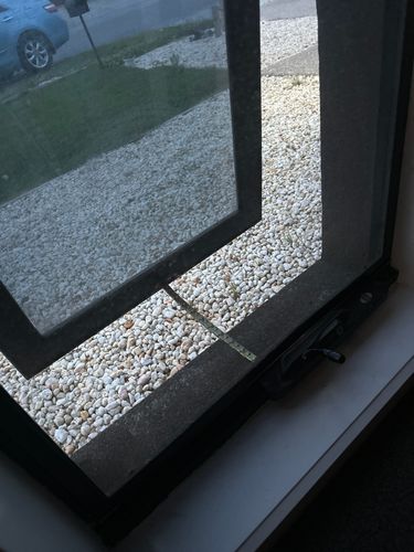

Hi, I live in a rental house and have a tilting casement window in my bedroom. Unfortunately, it’s the only window available.
The casement window tilts open from the bottom and has a fly screen attached.
My question is: how can I install a portable AC vent in this space?

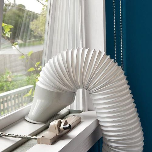

I would concur with the previously made suggested options, tilt out casement windows are the worst style for this type of modification, that given there's a commercially made product available that at the very least may inspire your own working solution (the elongated outlet is the key to the design) and
given the window is at ground I would  be concerned about just how far it needed to be open.
Olimpia Splendid - Cool Seal

Guys ! I just wanted to say a big thanks to each of you who tried to help me out. I am just in my twenties trying to figure all this out.
I managed to achieve a acceptable level of seal which has been cooling my room fairly good.
Amateur fix here with thin pvc foam sheets, duct tape and liquid nails to hold everything together.
