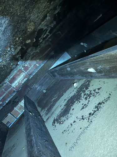

Afternoon @angelique5
Thank you for the photos, as @JacobZ says it looks in a resonable condition just wet.
I dont know of insurers charging to assess claims? I would follow that up by checking your insurance documentation as much as thats a pain. Also Fair trading Australia may be able to help you out with that type of question. As to an issue long term that would be assesed by the insurer. (Ive been through a process with a water leak for a bathroom and it ended up not being covered 😕 but no fee for assesment)
I really like the idea of a blower to dry the area out as much as possible. At the very least that will aslo help narrow the issue down if something else is causing the water to be around.

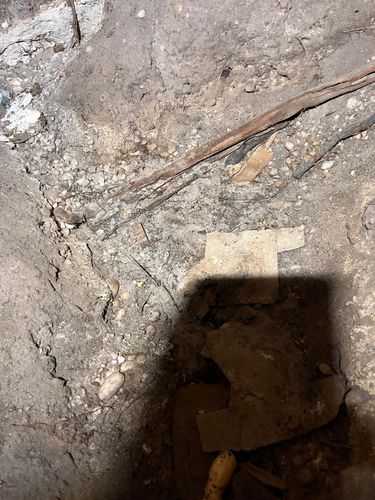

Good Evening @angelique5
Your ground looks pretty good Seriously I have deeper chanels under my house. The piers that you have shown all look ok and as to the earth that has been moved by water its not bad.
Before using vinigar I would go the route with the blower. Dry it out will kill mould and then use the application @JacobZ or @EricL mentioned from Bunnings.
Fans/blowers can be hired from the Bunnings hire section. Just hit them up. Factor in gettingthem out of your car and wherethey need to be placed size wise when hiring.
As to water damage under strata law. It may be a worthwhile look up with the goverment body over strata title as to whoose responsibility it is for the guttering that is joined/causing issues.
I think you will be nicely surpprised once you get the underfloor dired with a blower/fan.

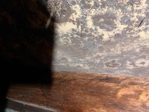

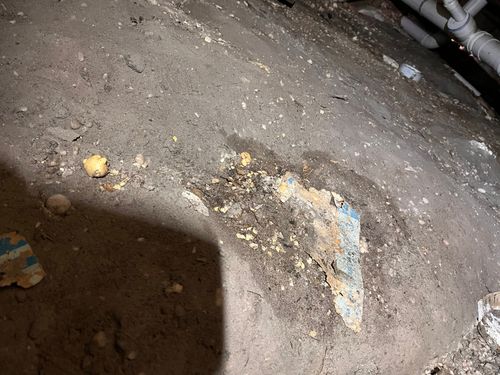

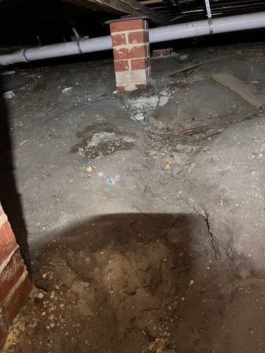

Thanks everyone for so much great advice, my neighbour is getting plumbers to check the downspouts if any are blocked next Monday, I researched the air blower and my only concern is will it blow all the mould spores around, I crawled under again right to back common wall and it’s worse on far left side with a bit of timber that seems eaten away , so much water on ground, and extensive mould, she wants me to wait for plumbers to check before lodge claim to asses , here are some more pictures
Re: How to treat mould on chipboard in closet under carpet?
Have you contacted the strata people yet? I am unsure of how /who has responsibility for a duplex styled house. It would be listed on your insurance papers.
It makes no difference if your neighbour says wait, or not as the damage is there and you want to have it sorted. Wether it is caused from the neighbours issues or not, the claim is the first step towards it.
