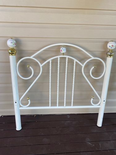

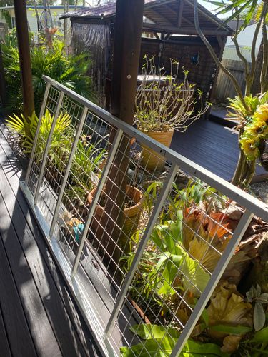

I have a pretty white metal bed that I would like to put together but the parts to hold it together were rusted & I threw them out. I cannot remember what the parts even look like , let alone what they are called. The square holes on the wire frame are 14mm & the bolts are 10mm. Hopefully someone can help. Thank you

Zenith M8 x 125 x 16mm Zinc Plated J Bolt
Plus
Pinnacle M8 Stainless Steel Flat Washer - 12 Pack
and maybe
Macsim 38 x 38 x 3mm M12 Galvanised Square Washer - Each
So the hook goes through the square hole of the rectangular frame, then could you put the large square washer against the end of the rectangular bed frame.
Next step (two ways you could go)
The threaded end of the hook goes through the rectangular frame then the large square washer, through the bed end frame out the other side then a round washer and then the nut.
or
The threaded end of the hook goes through the rectangular frame, then the large square washer, then a smaller one Plus nut. Another round washer, Then through the bed head, another washer and another nut or two nuts to lock it.
If you cant picture it I can try sketching it tomorrow :smile:
Only think Im worried about is how tight you can do it up to stop the rocking.

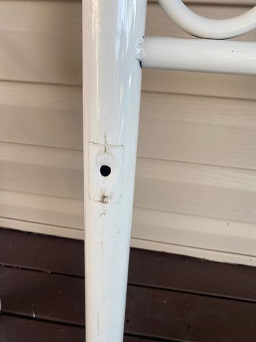

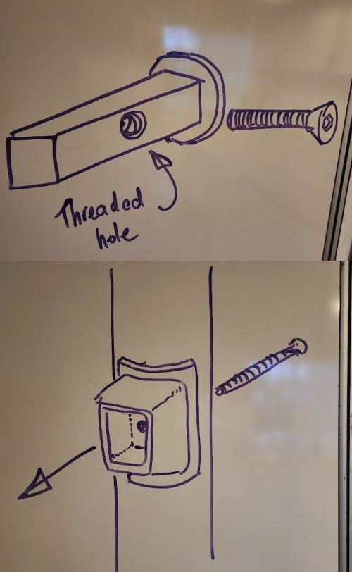

From memory (which is poor) @kerri11  - there were curved supports that fitted between the vertical posts and bed rails. Then square rods that had holes drilled and threaded were inserted into the rails with 'ends' that predicted the centre - to accept long bolts entering from the back of the posts, through the supports and into the thread. Then tighten.
They were long bolts with countersunk and Allen key (usually 5 mm) heads.
Of course I could be wrong. I've had only one cup of coffee this morning.
