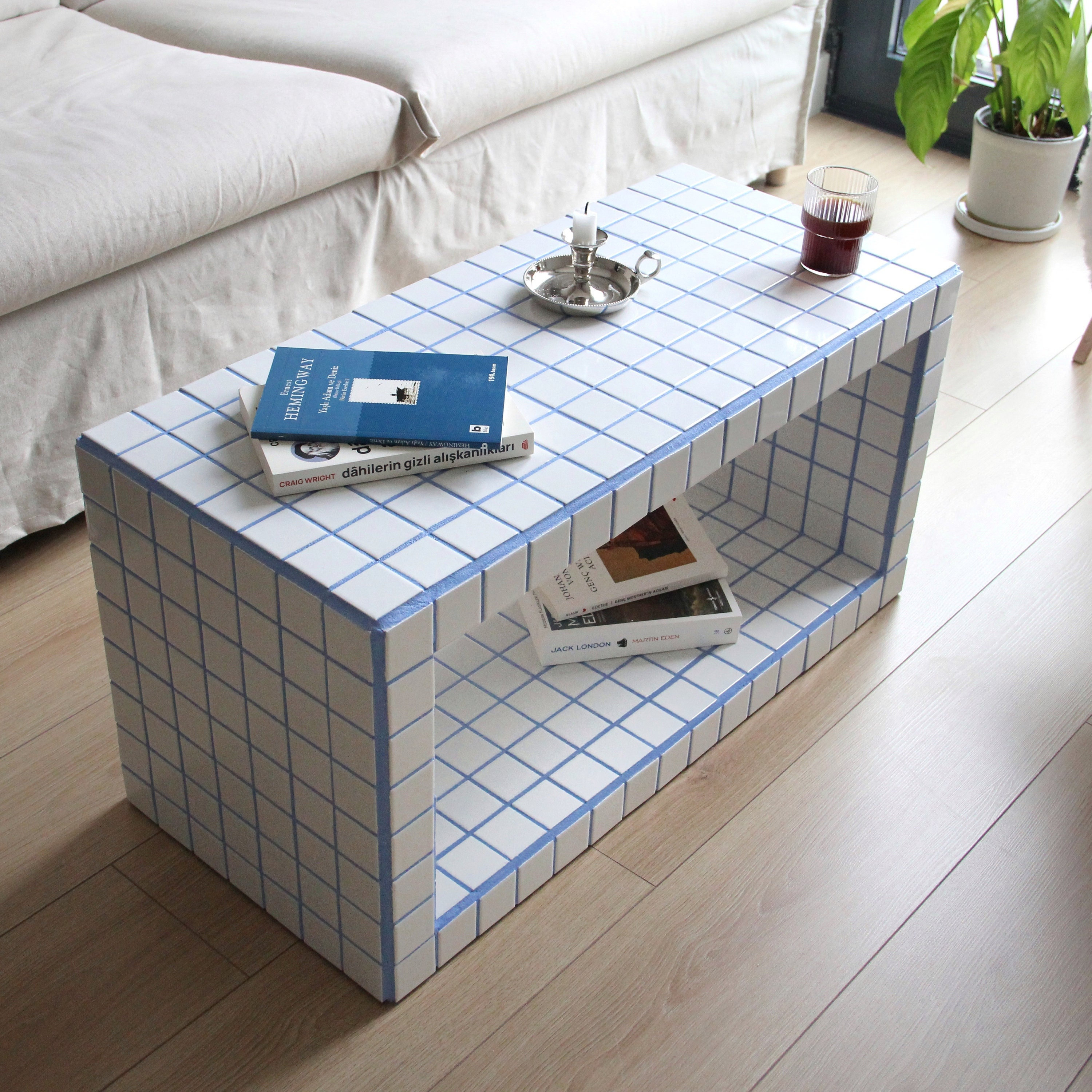

Well, I was going to use these mosaic sheets, which are 306 x 306mm, and so am thinking the table top could be 918 x 612mm (so, 3 x mosaic sheets by 2 x mosaic sheets). I started to wonder about the weight though, so I was thinking I could aim for this instead. The same framework (I assume) but keep the sides open?
Each tile is 47 x 47mm, so if you allow 3mm for grout, the table top could be 50mm or 100mm deep? (So one tile or two tiles deep?) I don't mind more grout showing at the joins like in that blue/white table linked above. And then I could possibly do the same width for the two sides? The height of the table would just be based on the mosaic sheets again, so maybe 459mm (1.5 x sheets).
I have attached a sketch of what I'm thinking (which hopefully makes sense), but I'm unsure how to go about the frame. EG would I choose pine that was at least 50mm deep, so it's already the depth of the table top/width of the legs that I'm after?

** Sorry!! I just realised that if the tiles are 47 x 47mm and grout needs 3mm, it's going to need 53 x 53mm to have enough space for tile + grout all the way around (this would affect table top depth etc).

I love your comprehensive sketch, it makes it very clear what you are trying to achieve, thank you for that. Your frame is almost exactly what was thinking.
70x35mm pine is my suggestion for the frame as it is very available, relatively cheap and fairly lightweight while still being very strong.
As you are using a comprehensive frame, you can use thinner plywood as it will used more as a backing for the tile than a component that creates the structure. This 2400 x 1200mm 7mm Plywood F8 Pine Structural CD Grade will work well with the size of the framing materials and the tiles. Using this with 35mm thick timber, you can have a sheet of 7mm ply on each side of the timber to have a width of 49mm, which is near perfect for the size of the tiles.
I am working on a render using the components I've mentioned above. You'll have to let me play around a bit to figure out what works best, but it is unlikely we'll be able to avoid cutting any tiles as there are so many corners and edges to consider in the design. I will try to make it so any cuts are on the inside of the coffee table, so they are hidden from sight.
