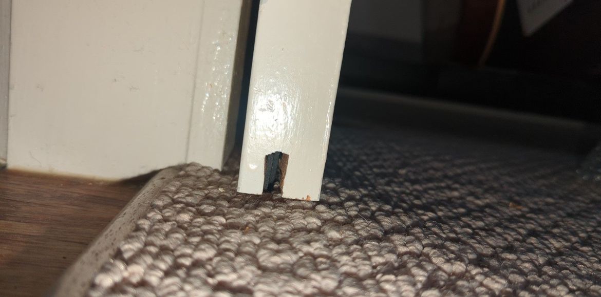

Hello!
I am not very handy but would like to somehow get a replacement door guide as the guide had snapped off.
The guide is under carpet. I am thinking there are a 2 options here:
1. Get underneath the capret, reinstall a similar door guide. Problem is I don't know how to get underneath the carpet?
2. Install a new style of door guide on door frame, can I just drill holes into my door frame? I am worried it will split the door frame.
Thanks in advance.

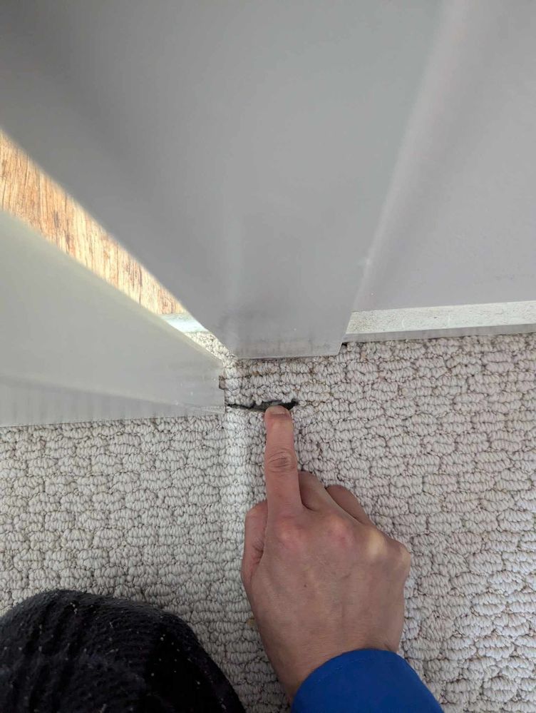

aaaaaaaaaaaaarr.jfif I found a dodgy way of overcoming this which has done the trick!! No worries for another 5 years hah! I slipped some L shaped metal pieces under that carpet slit and it holds and is acting as a door guide now.

If you wanted a more permanent solution, assuming there is timber or concrete beneath the carpet that you can screw to and the rebate in the door will accomodate, this Cowdroy Door Guide Floor Mount slipped beneath the carpet and screwed in place is likely your best option.
