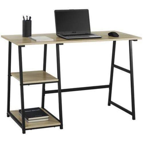

I am planning to convert this office table into the Bar/Dining table.
But not sure how to start? I was planning to paint the black color, but not sure which paint stable and waterproof? Color choice would be brass/gold or if not available then white. If you have any other idea to give it a new look, please tell me.

Any chance of posting a few closer photos of underneath this desk?
My thought is if it's to be a bar table, we need to remove some steel and those two book shelves.
Then we need to stabilise it.
What do ya think?

Do you plan to alter the frame at all as @Noyade has suggested? Or do you simply plan to spruce it up with a change of colour and maybe some new timber tops?
There are options for gold paint such as Dulux 325g Duramax Metallic Gold Spray Paint which you could repaint the legs with. There are also options for bench tops such as this SpecRite 1200 x 600mm 18mm Timber Panel Okoume FJ Laminated which could be used as the top and shelving depending on your style preferences.

Do you want the front or sides covered (depending on where it will be sitting) The frame for that type of desk isnt particulary solid and Ithink it could handle some cladding added to it but not a lot.
If you do decide on cladding maybe something onlg the lines of James Hardie 4200 x 230 x 7.5mm FC Woodgrain HardiPlank Weatherboard
with the top that @JacobZ has suggested. My concern is too much weight and it will fracture the welds on that thin tubular steel.
