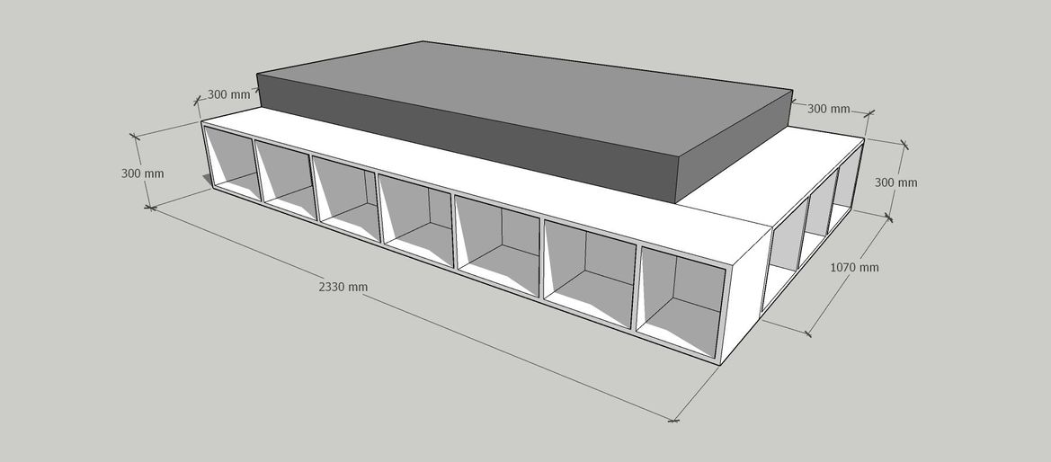

I’m a beginner DIYer, and I’m trying to make an L-shaped platform for my king single bed. The platform will go around the bed, and it needs to be sturdy enough to support weight because it will be stepped on regularly.
I’m using wood for the construction, and I’d like to make it modular, with detachable cube storage units. I’ve planned the following dimensions:
I’m not sure how to go about putting everything together since I’m new to DIY projects and don’t have many tools. I want to make sure it’s strong, stable, and safe. Here’s what I have in mind:
Materials: I’m planning to use wood, but I’m not sure what type to use. Should I go with plywood or MDF? Is one better than the other for this kind of platform?
Tools: I have basic tools, like a saw (hand saw or jigsaw), a drill, screws, wood glue, and a screwdriver. Will that be enough? Should I invest in any additional tools to make the process easier?
Assembly: I want to make sure the platform is sturdy since it will be stepped on often. How should I join the wood pieces together? Should I use screws, nails, or both? Are there any special techniques I should know to make sure the platform is strong and won’t wobble?
Modular Storage: I want to make the storage cubes detachable and modular. How do I ensure they are easy to assemble and rearrange but still secure enough to hold items? Any advice on creating modular sections that fit together well?
Finishing: What’s the best way to finish the wood to protect it from wear and tear? Should I paint it, stain it, or just use a wood sealant?
I’d really appreciate any advice or tips from anyone who’s done something similar before!

I'm having a bit of trouble understanding the positioning of the platform, it's function and the relation between that and the measurements you've provided. Again, I'm not sure how the modular storage comes into play on a platform that is only 9cm tall. Will they sit on top of it? Were you planning on building these cubes too, or using pre-fabricated cube storage?

the modular part of the platform would be the two separate pieces of the cube storage, I think I worded it wrong, I might the piece are detachable for easy removal if need be I hope these drawings are alright many thanks ☺️

A typical king single is generally 107cm wide by 203cm long. Can you please confirm the size of your king single just to make sure the size is correct. Do you wish the cubicle step to go the entire length of the bed? I'm just curious about sizes you've given as it appears that it will not be covering the entire length of the bed. Please give me some time to draw up a sample image of your project and you can correct the measurements as we move forward. As soon as I finish the sketch, I'll post it here.

I'm still having a great deal of difficulty in trying to understand the relationship between your measurements and the sketch you've drawn.
Where, for instance, would the 9cm/90mm of height be?
In answer to your questions, you could use either plywood or MDF, but MDF is great as it has no splinters. The tools you have currently would be enough to construct the platform base. To join the wood pieces I would screw up through the Cube storage and into the bottom of the timber panel, just ensure you use screws of the correct length so they don't penetrate the top of the panel. You can remove these screws if you wish to move or rearrange the system. Either painting, staining or coating the timber with varnish would be perfect ways to finish and seal it.

I originally thought you might have a high ensemble bed and need assistance getting in and out.
But the dimensions don't seem to pan out.
To put scale to the project - that plastic container seen below is 90 mm high and 130 mm wide. I was thinking shoe storage, but you'd be lucky to get a pair of socks in there?
When you consider the wood thickness, that 'storage' shrinks even further - maybe 60 mm height.
I'm thinking build bigger and use dressed pine.
See what you think.
