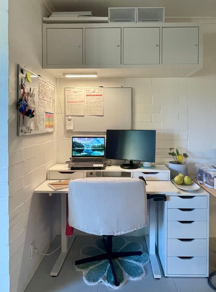

I work from home and currently have a couple of smaller framed magnetic whiteboards on the wall above and next to my desk. I'd like to create a more streamlined/minimal look that covers the whole space above my desk while retaining the magnetic and whiteboard functions. I'm thinking of using an adhesive whiteboard roll/film and attaching that to a piece of sheet metal of some kind, then putting that up on the wall (brick), but haven't gotten any further than that - any ideas for the sheet metal/backing or how to put it together and attach to the wall?
