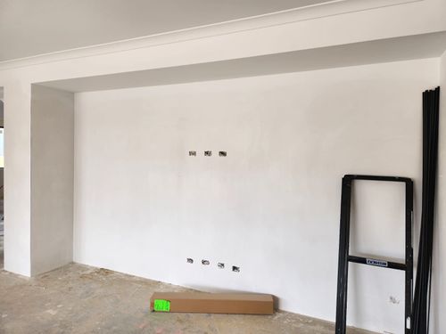

I am looking at who can point me in the right direction to achieve this.
What kind of wood and the right tools to DIY this .
