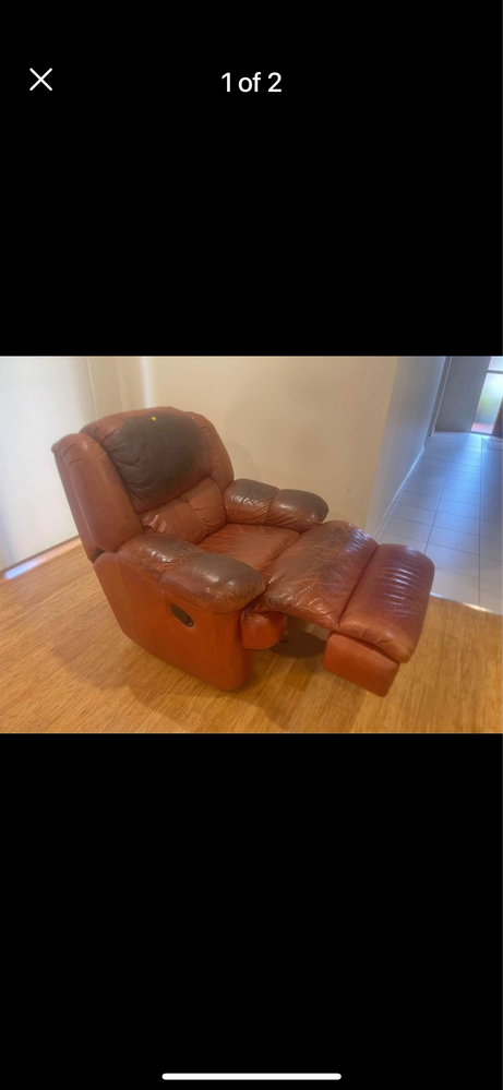

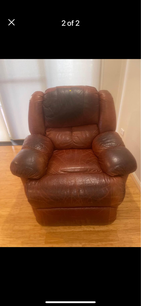

I want to pick up this couch however I also want to clean it and paint it? Help on how to do this? I want to keep it a brown rustic colour so it would be going over it again in the colour it would have been without all the dark marks.

The steps to painting your leather chair is composed of three general steps. They are cleaning, painting and sealing. The most important step is the cleaning, failure to remove all the wax and oil deposits on the leather chair will cause the paint to bind poorly, crack and peel off.
However, the cleaning product you use will matter significantly as using the incorrect cleaner can damage the leather finish. The safest method is to use a mild detergent with warm water and a microfibre cloth. Just keep in mind not to leave puddles or wet spots on the leather surface. As soon as you wash and rinse a section, dry it off immediately with a dry microfibre cloth.
The specific paint to use for leather furniture is called a leather acrylic paint. You'll need to source this from specialty stores or dedicated furniture repair shops. The difference between household acrylic paint is that leather acrylic paint is specifically made for leather, making it more flexible and can be applied directly to leather without being diluted.
The final step is to use a leather finisher, this will protect the paint from minor scratches and everyday use. Keep in mind to give the leather paint enough time to dry off before applying the finisher.
