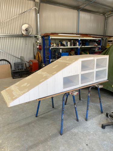

My gorgeous Goldie, Charlie, was recently diagnosed with hip displacia. This condition makes ordinarily simple movements incredibly difficult. It is for this reason that I decided to build a ramp to allow her easy access to some cuddles on the bed. I worked hard to match the bed frame and decor in the room with bright whites and paneling to finish.
Materials
Tools
Ryobi Drill
AEG Drop Saw
Ryobi Disc Sander
Steps

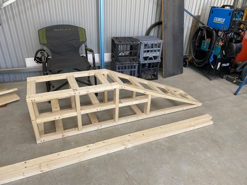

Step 1
1/7Build the frame using 35x70mm untreated pine. If adding shelving or draws, ensure this is calculated in the frame build. Secure the frame with 75mm 10G Timber Screws.

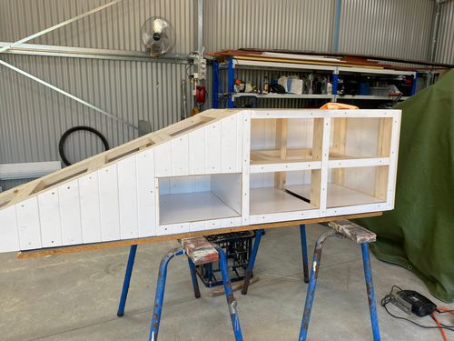

Step 2
2/7Carefully cut pine cladding to size and secure using 30mm 8G timber screws. Be sure to counter sink screws using a larger drill bit.

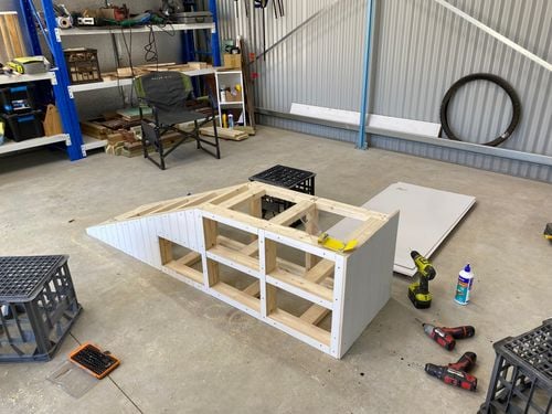

Step 3
3/7Using 3mm coated MDF board, measure and cut shelving lining. Secure in place using indoor wood glue and 20mm 8G screws.

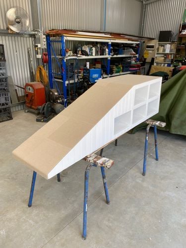

Step 4
4/7Measure and cut the 9mm MDF top. Secure using countersunk 50mm 10G timber screws. Patch all screw holes and imperfections.

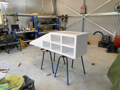

Step 5
5/7
Use white gap filler to seal the edges of the shelves. Sand the ramp back until the surface is completely smooth. Apply a coat of prime, followed by 1 coat of white wall paint.
Step 6
6/7 
Add your chosen material to the ramp top.
Step 7
7/7Upon installing the ramp and observing Charlie using it, I realised the carpet was far too slippery. I then replaced it with these great foam-based self-adhesive panels.
