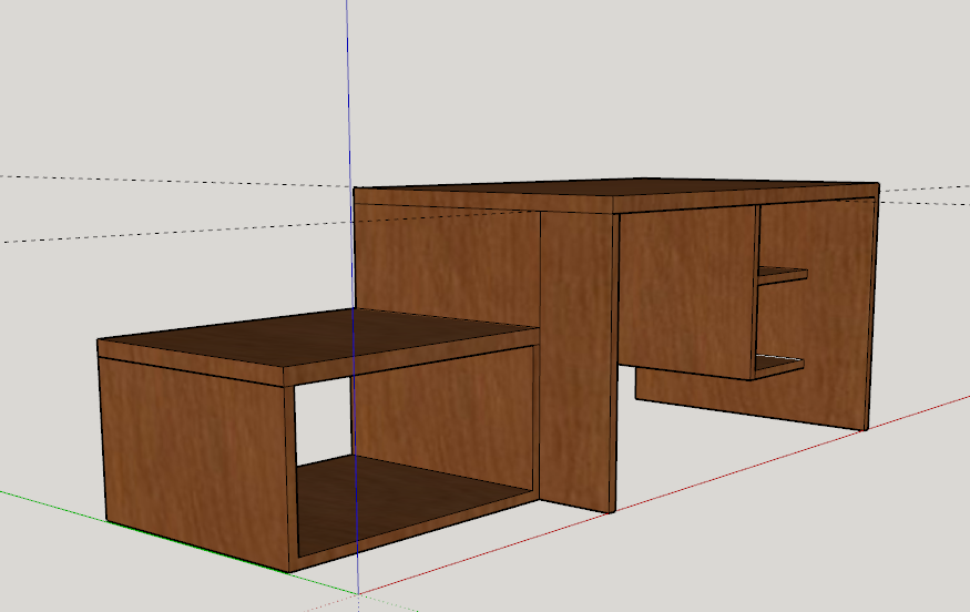

desk.jpgThanks for the feedback, I do have a design i did via Sketchup that i have uploaded it above. Ill have a look at the google suggestion to.

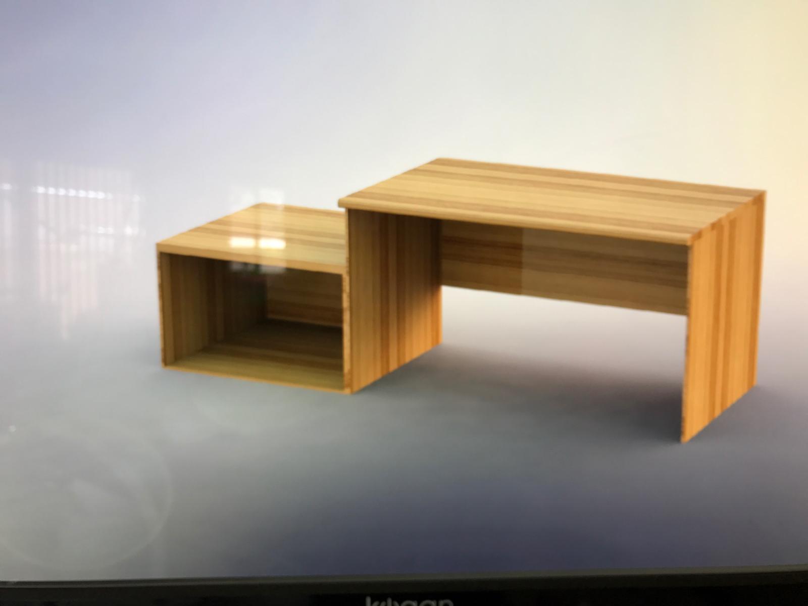

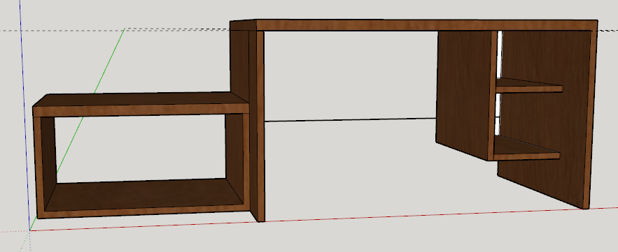

Here are 2 better images. There will be a 4mm back board on this
I am concerned with the strength of the join between desktop and side. I have been trying to figure out the best way of making it stable This is all solid wood, no MDF, i am trying to avoid using screws/nails through the top to keep the finish. I don’t have a lot of practical experience so advanced joints are out.Desk1.PNGDesk1.PNG

Have a look at Cam Dowels and Locks.  Makes the desktop removable if you ever want to move it.

The joint you mention between the desktop and side would appear to be the weakest point. You could possible add a cleat (maybe 25mm square) or even a piece of steel or aluminium angle which could be screwed from the underside to both the top and side panel, perhaps recessed back from the front so as to not be immediately visible or also add a 50mm skirt to the underside of the front and back of the desk sitting area.
