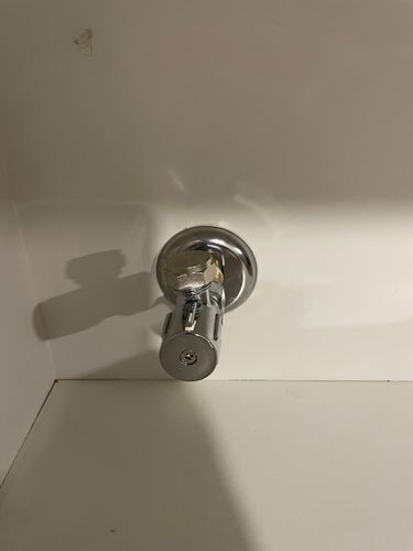

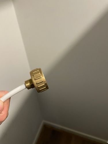

Hi I have recently moved house. And my fridge connection is too big for the tap connection. What do I need to be able to connect this?

When you say it's too big, how much bigger is it? If you could measure the distance across the face of the fitting between the threads, that would give our members a much better idea of what you're working with. If your fitting is 20mm, then a Brasshards 20 x 15mm Brass Threaded Hex Reducing Bush would increase the size of the mini-cistern cock to suit. Similarly, a Brasshards 25 x 15mm Brass Threaded Hex Reducing Bush would increase it to 25mm.
If your fitting is 20mm the better option might be to have a plumber switch the mini cistern cock to a Kinetic 15 x 20mm Chrome Plated Double Mini Cistern Cock that has the 20mm fitting on it already. Remember that adding fittings or changing taps is considered plumbing work and requires a licensed plumber to complete it.
