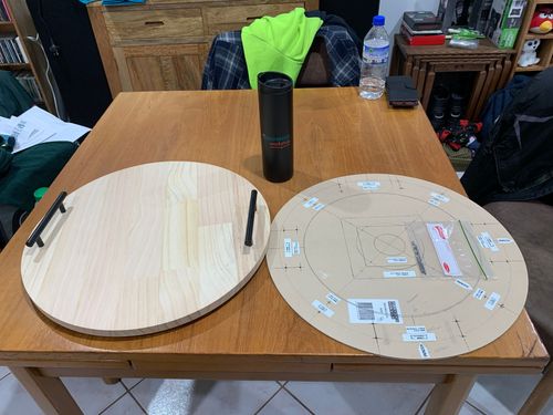

As a team member for Bunnings here in not so sunny at the moment WA, I’m putting together a DIY workshop for gifts for Father’s Day this coming weekend, showing customers how to make serving trays…. So dads can get served breakfast in bed! Hopefully 🙏
Of course they can also be used long after Father’s Day has passed.

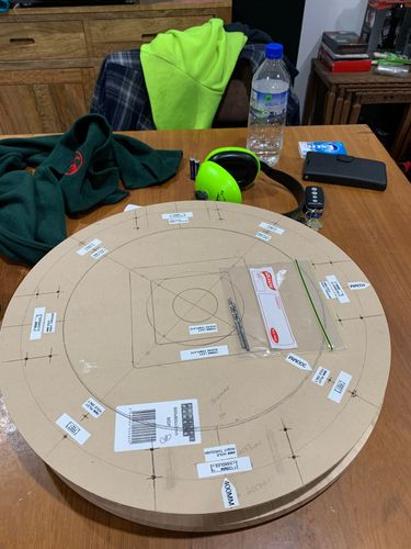

I really just picked the handles I wanted. On the 450mm round with the plastic still on it, I divided it into 4 triangles to find the centre of where to put the handles on the edge, pre drill 4mm holes all the way through for the handle screws and on the same side pre drill (but not all the way through) with a 3mm drill bit for the feet.
Screw it all in place and viola there you have it!

Love the template you've made up @hazesnow! It looks like it would make these trays super simple to knock up. Were you making some Lazy Susan versions too?
Re: Serving tray
@MitchellMc it does have the lazy Susan template in the centre as well!
