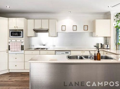

Hi, just wondering if it would be possible to panel my kitchen bench directly onto the existing surface. Thanks

When you say panel your kitchen bench, are you referring to re-laminating your kitchen benchtop surface? If you are, there are some conditions that must be met in order to allow you to re-laminate the benchtop.
The surface must be flat and free of damage, large portions with missing laminate must be repaired first before putting on the new laminate surface. The edge of the benchtop must be square and not rounded, bullnose edging can't be manually resurfaced.
If you meet these conditions, then it would be possible to re-laminate the surface of your benchtop. If you've not done this before, I suggest engaging the services of a builder that has experience in doing this type of revamp.

It sounds like you might be thinking of something along the lines of these fantastic projects contributed by @ProjectPete: Kitchen island EasyVj panelling and Bamboo panelling on kitchen island. If so, you can totally apply them over your existing surface and it's an awesome and simple way to change up the look of your kitchen.
If you have a certain panel in mind I can provide detailed advice, but in general, you'd scratch up the existing laminate or surface so adhesive can adhere, place the panel which has been cut-to-size in position and then screw or nail it into place. The fixings will hold in position until the glue dries.
Obviously, you wouldn't want to put a fixing through the front if it's going to ruin the aesthetics. I'm keen to hear more about the type of panelling you wish to use and provide further assistance.
