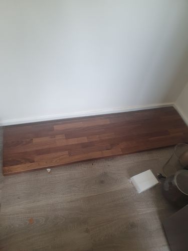

I.want to install this benchtop piece (1600mm x 400mm) as a breakfast bar. I would like advice regarding my.options for installation. The wall it is attaching to is double brick. I am open to all options. My priority is of course having a stable installation.

For installing your breakfast bar onto a double brick wall, the best approach would be to use Carinya 380 x 380 x 40 x 6mm Heavy Duty Angle Brackets for support. These brackets are a straightforward and reliable solution, providing ample support for the benchtop. Ideally, you would want at least three angle brackets to distribute the weight evenly along the length of the breakfast bar, ensuring a stable installation.
While angle brackets are a great option, a more robust solution for long-term stability would be using stayed brackets. These brackets provide additional support by preventing any flexing of the benchtop. However, the downside is that stayed brackets are less aesthetically pleasing and can obstruct the space underneath the benchtop, particularly making it harder for knees to fit comfortably.
Since your priority is having a stable installation, using three solid angle brackets should be sufficient. If you are willing to sacrifice some aesthetics for extra stability, you might consider using stayed brackets as well. To install the angle brackets, you will need to drill into the double brick wall and use appropriate masonry anchors for secure attachment. Make sure to position the brackets at regular intervals along the benchtop's length for an even distribution of weight.
