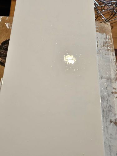

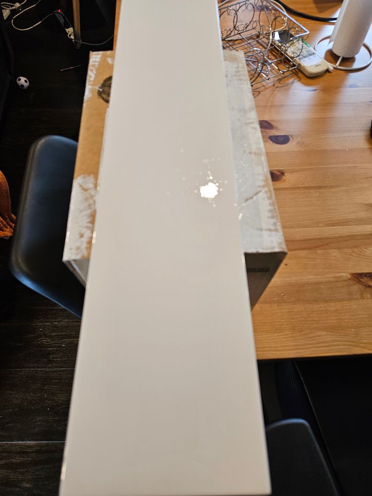

Must I sand the 2 pack paint away before applying the enamel paint?
I also need to fill a small hole on the panel before painting it.
What can I use to seal the enamel paint soit doesn't come off or peel?

Ultimately, sanding the two-pack off would be the best way to ensure that your enamel paint adheres correctly. Even if you were to sand the gloss back, there's no guarantee that a primer will adhere to it. Given this, I'd recommend sanding the two-pack off entirely and using the Dulux 1-step on the timber, and then, once dry, Dulux Aquanamel over it. It's important to know that the two-pack product is an extremely durable industrial-grade coating, whereas the Aquanamel is significantly softer. It would be fine for a quick refresh, but it's not a long-term solution for a paint coating in a high-wear environment like a kitchen.
If prepared and applied correctly, there is no need for an additional sealing coat to prevent the enamel paint from peeling.
