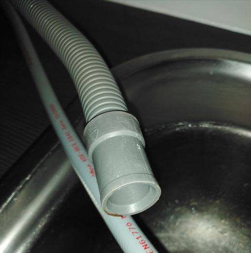

So, have been setting it up today and have found the hose that drains the water out is perhaps too short. Can it
be affixed to the other hose with tape or is it better to buy a longer one. Not sure if working out something on a tile would suffice as it would make it even shorter.

Hi @MinB,
What was the other hose that you would like to fix it to with tape? Taping hoses together isn't normally a great idea when water is involved and having a complete length would be preferable. If you could tell me the size of the rubber fittings on the end of the drain hose, then I can look for a suitable replacement. If the benchtop dishwasher uses the same size fittings as a standard dishwasher then a Kinetic 4.1m Grey PVC Washing Machine And Dishwasher Outlet Drain Expandable Hose would work. There is also a variety of sizes in clear vinyl hose that you could use too.

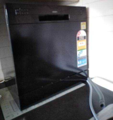

The silicone mat was actually lined up rather well, but I needed to get to the power outlet at the back so needed to shift the dishwasher a tad.
The drainage hose does go over the edge, but as you see it also sticks up in the air too.

Re: Benchtop DishWashers & Bench Top Surfaces.
This Estilo Sink Hand Spray could be an option @MinB. As luck would have it, it even has a click-on fitting that would work with your click-on adaptor on the tap. That works out perfectly, and you can easily change between the dishwasher and hand spray!

Looked in the dishwasher manual and online, but can't find what kind of hose it is.
I would think normal like any other dishwasher maybe. Surely.

You'll need to check the back of the dishwasher to see how the hose is connected to it @MinB. It might be held in place with a clamp. If this is the case, you can undo that clamp and install the longer hose. If the current hose on the machine can't be removed, then the Kinetic 4.1m Grey PVC Washing Machine And Dishwasher Outlet Drain Expandable Hose has a few different sized rubber fittings on it, and hopefully, one of those will push firmly over the end of the current hose to extend it. The addition of some tape would assist them from coming apart. However, I wouldn't advise relying on tape alone to hold them together as it could fail.
