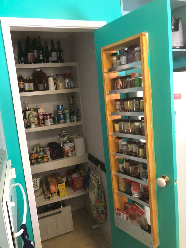

Spice door design feature
- The  spice racks are 100mm wide allowing for a double row of standard spice jars or larger  diameter bottles.
- The bottom spice shelf has a  back on it  to allow sauce mix packets and or packet spices to stand there.

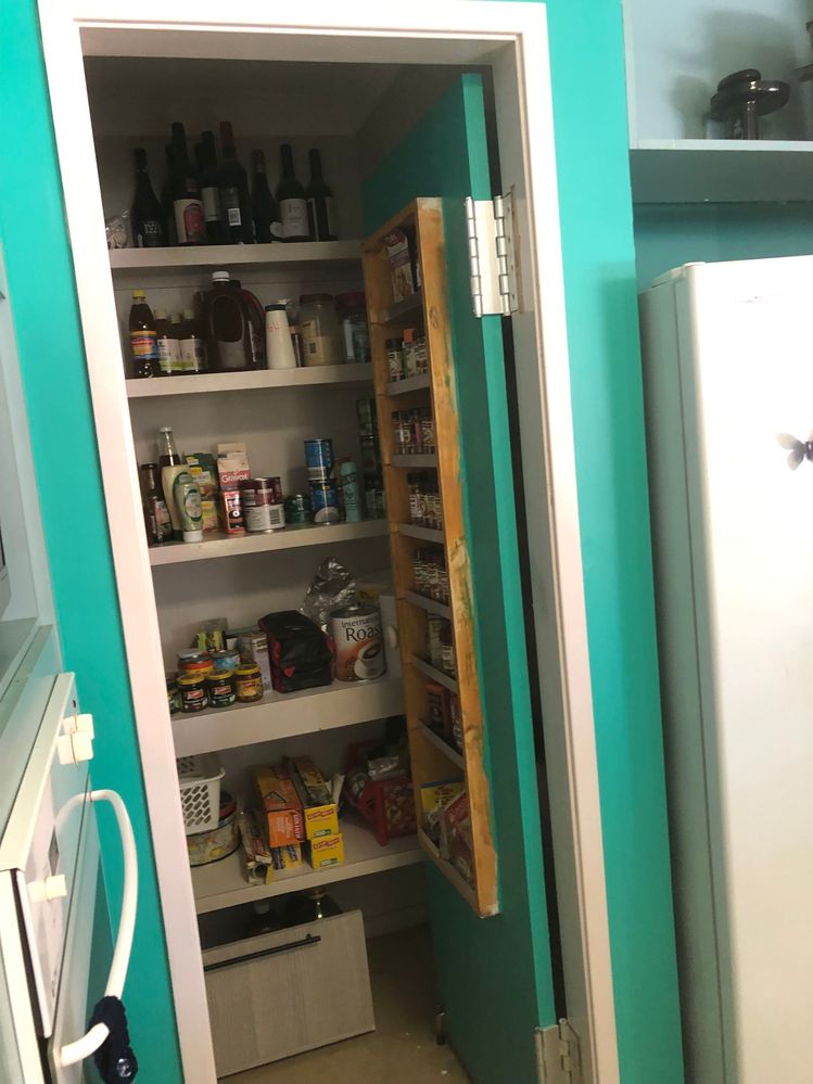

-The door now has double swinging hinges allowing access  to new storage behind to door (previously unaccessable)
-The door has foot stopper to allow the door to be held open into or out of the pantry.

- Standard bottle spice rack capacity approx 98 spices  as shelves double sided. More spices if squeezed in or make spice rack bigger in door.
It looks like an easy project but there where several surprise problems to overcome as in most projects.
Firstly that door  is a hollow Thin ply like wood outer and cardboard inner honey come cardboard and 20 to 30 mm outer edge of timber.  So I had to add internal timber same thicknessas inside door to support the spice rack  timber frame down to the door internal base so the weight of the rack and spices would not twist and buckle the  whole door.
Door opening into kitchen allowing access to potental second row of spices and access (previously unreachable) behind the door for hanging stuff and ease of cleaning now.
Door Pinned open into the pantry allowing ease access while  cooking etc.
Door Hinges
Limitations the door cant carry unlimited weight currently working perfectly (I did use Bunnings heavy duty  quality hinges approx $75 each and I can always add more hinges to door if required, The cheaper small hinges I tried wont carry weight) as the spring loaded hinges will drop and not operate well. I might be able to get a couple of regularly used sauce bottle into it but where  do you stop.  The hinges i used are not designed to be mounted onto a flat  door frame (It should mount onto frame approx 38mm wide same thickeness as door approx the hinge part has room to move). The problem with flat mounting these hinges is they need to room to open and the only way was to create slots into the timber frame to allow the hinge to drop into for proper door opening into the room.  Opening the other way was fine as  hinges where mounted on inside of door frame where the original position of door was. Slots a  little messy I have cleaned and painted them now.  You  can buy hinges that allow  proper flat mounting but very expensive $100+ ea

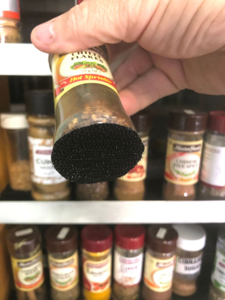

So all these spices  sitting in the door so how do you stop them  falling out eact time door opens and closes?
Well  i used 100mm velco strip (Bunnings velcro, I was suprised they stock these items)  glued on to  the base of the shelves and I cut out round velcro for each of the  bottles I wanted to mount in the door plus some extras for new jars.  If we buy the same new spice  we can open old bottle and add spices into old but good jar to save revelcroing every spice purchase.  The glue on the velcro wasnt strong enough the hold the  round  dots to the jars as  we  grabbed the spices so i used builders liquid nails that worked.IMG_4068.JPG

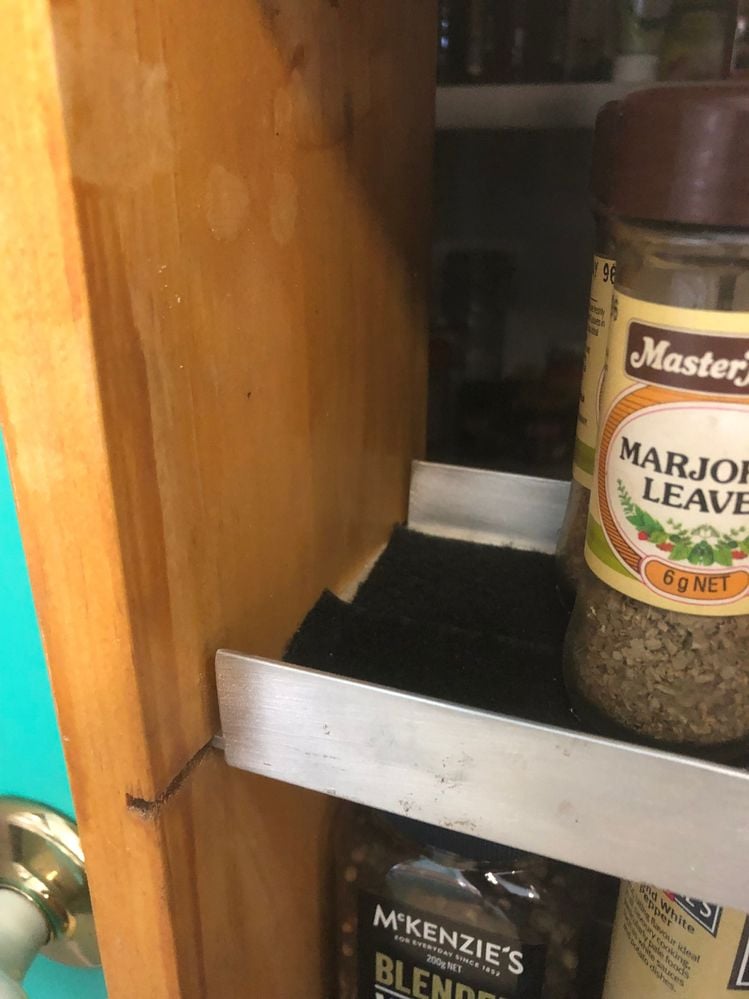

Aluminium Shelves
I orgininal set out at a metal specialist to buy some C shape aluminium 100mm wide with 20mm edges for shelves but they said they would have to order them in specially so I changed plan on the spot and bought 100mm wide flat 3mm thick and 2 x 30mm angle.  Notice the timber frame has saw cuts that the flat aluminiun slotted into nicly as saw was 3mm blade too. I cut the  angle and simply glued them on to the flat plate with  liquid nails.  I glued the shelves into place to stop them moving. Some may want to fill saw cuts and hide them i am ok with them.
