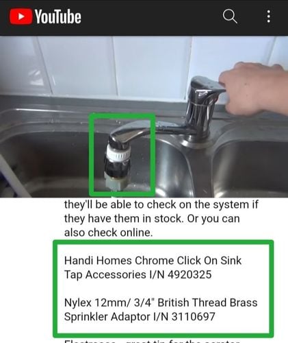

5 years ago (YouTube video) a person could buy two parts to make that connection: a) Sink Tap Click On and b) NYLEX brass sprinkler adapter.
Bunnings seems to not sell either anymore.

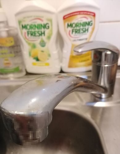

1) MY KITCHEN TAP: Is this ideal for a dishwasher hose to be attached and also easy enough to take the aerator off?

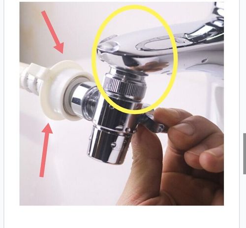

2) TAP CONNECTIONS YOUTUBE:
This is what BUNNINGS sold 5 years ago so are these still available or is something else now in their place?

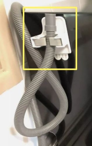

3) HOSE HOLDER(?): What is holding this hose up? Does Bunnings sell anything like this, also, a contraption that can keep the drain hose fixed to the sink area whilst the dishwasher is on.

You should find it a reasonably easy conversion to adapt the dishwasher hose to your taps aerator connection.
To establish a quick-connect system so you can easily remove the hose, I would suggest you start by unscrewing the aerator. You can use an adjustable wrench for this and you'll grip the aerator on the two flat sides. Once the aerator is removed, install a Pope Indoor Tap Adaptor onto the end of the tap. Then screw a Nylex 12mm Brass Sprinkler Adaptor into the end of your dishwasher hose. A Holman 12mm Double Ended Hose Connector will join the two male connectors. The Pope Indoor Tap Adaptor has a clip that allows you to quickly disconnect the fitting and hose from your tap.
It appears your image depicts a broom holder which is holding the hose in place.

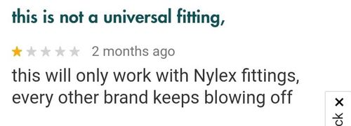

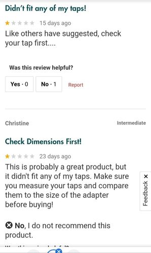

This concerns me as well about the NYLEX sprinkler option and POPE adaptor:
NYLEX:
POPE ADAPTOR:
Bunnings should actually be supplying one suitable component with it being the only main Hardware store nationwide.
Re: Benchtop DishWasher Tap Connections & Other...
Hi @MinB,
You might like to check out the other sprinkler adaptors that are available instead. Perhaps the Nylex 12mm British Sprinkler Adaptor? The Pope Indoor Tap Adaptor is suitable for taps with M22 x 1 female and M24 x 1 male threads, so it would be best to measure your tap once you have removed the aerator.

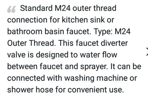

Would this be fine?
M24 outer thread although no idea how that factors in.

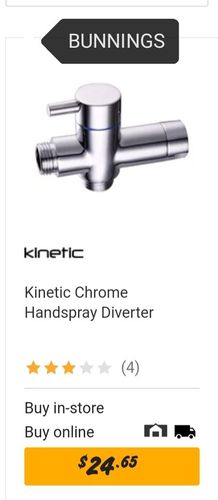

Found something!
Would this be it from Bunnings and would it work by itself or would something else be needed for the hose to fit?

Hi @MinB,
The Kinetic Chrome Handspray Diverter has a 1/2 inch female BSP fitting for the inlet. You'd need to remove your aerator off the tap to see if it has a 1/2 inch male BSP fitting to suit.
As per my post above, the Pope Indoor Tap Adaptor, Holman 12mm Double-Ended Hose Connector and Nylex 12mm British Sprinkler Adaptor will allow you to connect that standard type of dishwasher hose to your tap.

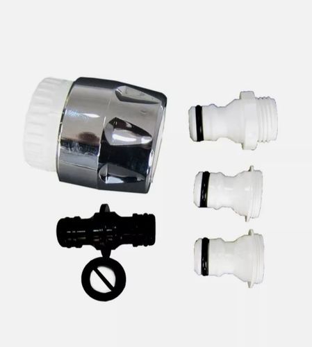

Please allow me until after the weekend, and I'll make enquiries to see if we can special order the Handi Home Click On Tap Accessory for you. That will allow you to connect with two products instead of three.

It appears the Handi Homes click-on kit has everything you need to connect your dishwasher to your tap @MinB. There is a possibility that you might need the Nylex 12mm British Sprinkler Adaptor as it is not clear if the parts included in the kit will fit your hose.
I've received feedback from our supplier Icon plastic about the Handi Homes sink tap click-on @MinB. For the benefit of others that read this discussion, they are no longer available for us to order.
