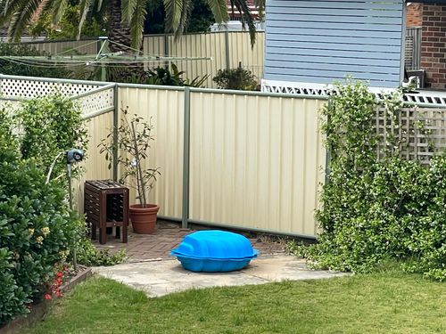

I’ve got a space (included in pictures) which is part concrete slab and part brick paving which is sat on mud (no base or sand).
I’d like to do something creative with the space but the first stage is to cover the area. I know that best practice is to use a base material, cover it with sand and then put pavers on top. Just curious whether to keep the bricks where they are and build on top or take them out and start from the mud layer…
The other part of the project I’m thinking of running the Jasmine along the wall and replanting a 2m magnolia tree in the corner. Add some chairs or even an arbour of some kind and have a nice reading space.
I’d welcome any feedback on those ideas! Note; I’ve never done anything like this before and ideally I’d do it myself (with the help of a Father in law)…

With any paving project, you are best to start with a clean slate. I'd suggest removing what is there and starting fresh, that way you can adjust the heights, add your base and add drainage to the space if required. Check out How to install garden drainage and How To Prepare And Lay a Base For Pavers for some guidance.
It will be fairly easy to remove the brick pavers, but you may need to use a jackhammer to remove the concrete.
Remember to take into consideration how high you want the finished surface to sit. If, for example, you use 50mm of drainage gravel or road base and a 50mm thick paver, you will need to excavate 100mm below your finished height.

Because of the slope of your yard and how it looks like the low point of the yard is that corner I am thinking of a low level deck as a solution.
You would still need to lift the pavers (no point covering a resource you can use later) but the concrete can stay.
Then as long as the timber is say 50mm above the concrete you have a base level of your joists to start from.
